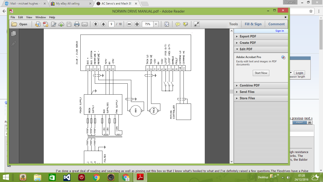

Hi all
Looking to convert my Denford Senior which has a Fanuc OT control to Mach3 using a CSMIO/IP-A Ethernet Motion Controller (+/- 10V).
I was hoping to use the existing Sem motors and Norwin drives. It looks to me like the drives need +/- 15v to control the motors.
All the available motion controllers seem to be +/-10v.
Can this be done??
Any help would be great.
