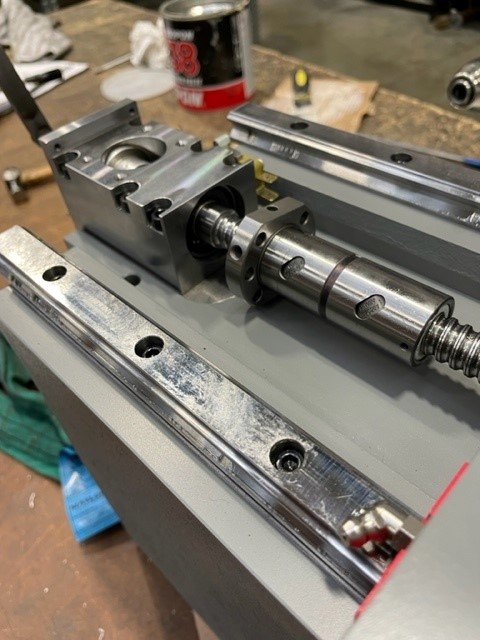

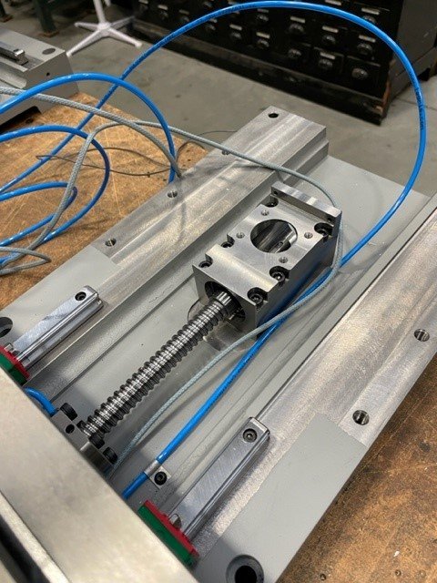

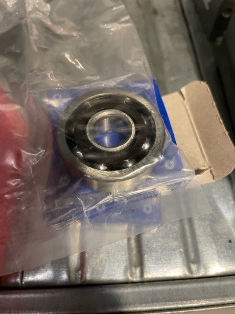

Its not easy to see so took some photos from machine assemblies. The bearings are in the same place by the motor mounts.

Thanks Steve. So there is one "axis rotary bearing" per axis and it's an unshielded ball bearing at the far end of the mount from each axis motor. That should be a fun task to access those with a syringe!
Re: Seeking lubrication clarity
Post by Steve » Mon 19 Dec , 2022 17:31 pm
They will be packed from new and will probably last for years without lubrication.

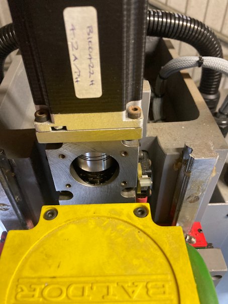

Post by johnparker » Wed 09 Oct , 2024 18:16 pm

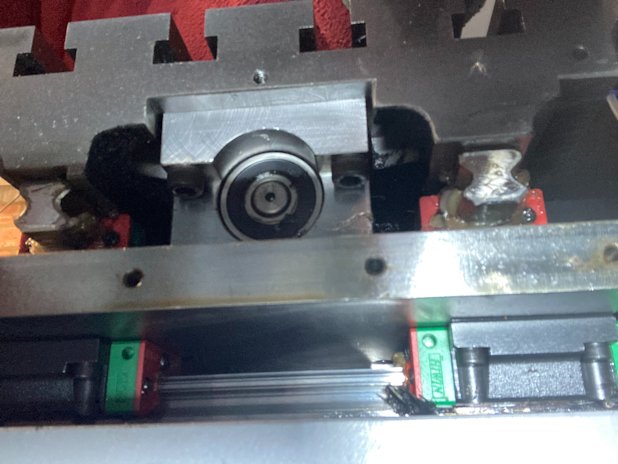

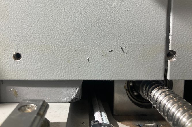

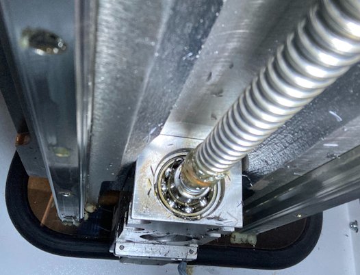

Belated update on lubrication of axis screws rotary bearings. I used a syringe on 3 bearings, the X right you can see in the pictures is sealed so I left it alone.
X Right.jpg (49.5 KiB) Viewed 8650 times
X Left.jpg (46.36 KiB) Viewed 8650 times
