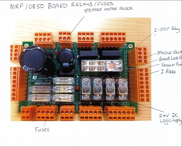

Check the relay contacts all switch on the distribution circuit board when Estop is pressed/released.
(the biggest one on the PCB shown here viewtopic.php?t=3038 at the bottom next to the Transformer)

The error indicates a fault with the E Stop relay or guard switch.
It may be the E Stop relay is stuck. If you remove the cover from the electronics you will see the pcb with 5 relays on it. Tap the relay sharply with the handle of a screw driver this will unlatch it if its the problem.
If this does not resolve the problem then call Denford and arrange a service visit.

As it turns out the E-Stop Relay contacts were sticking. A firm tap was all it took to free them up. All back and running again.
I will attach a picture of the board and indicate the E-Stop relay for those that follow.
Thank you all for your support. This community is full of helpful and knowledgeable people.
- E-Stop Relay Board.jpg (381.65 KiB) Viewed 18135 times
