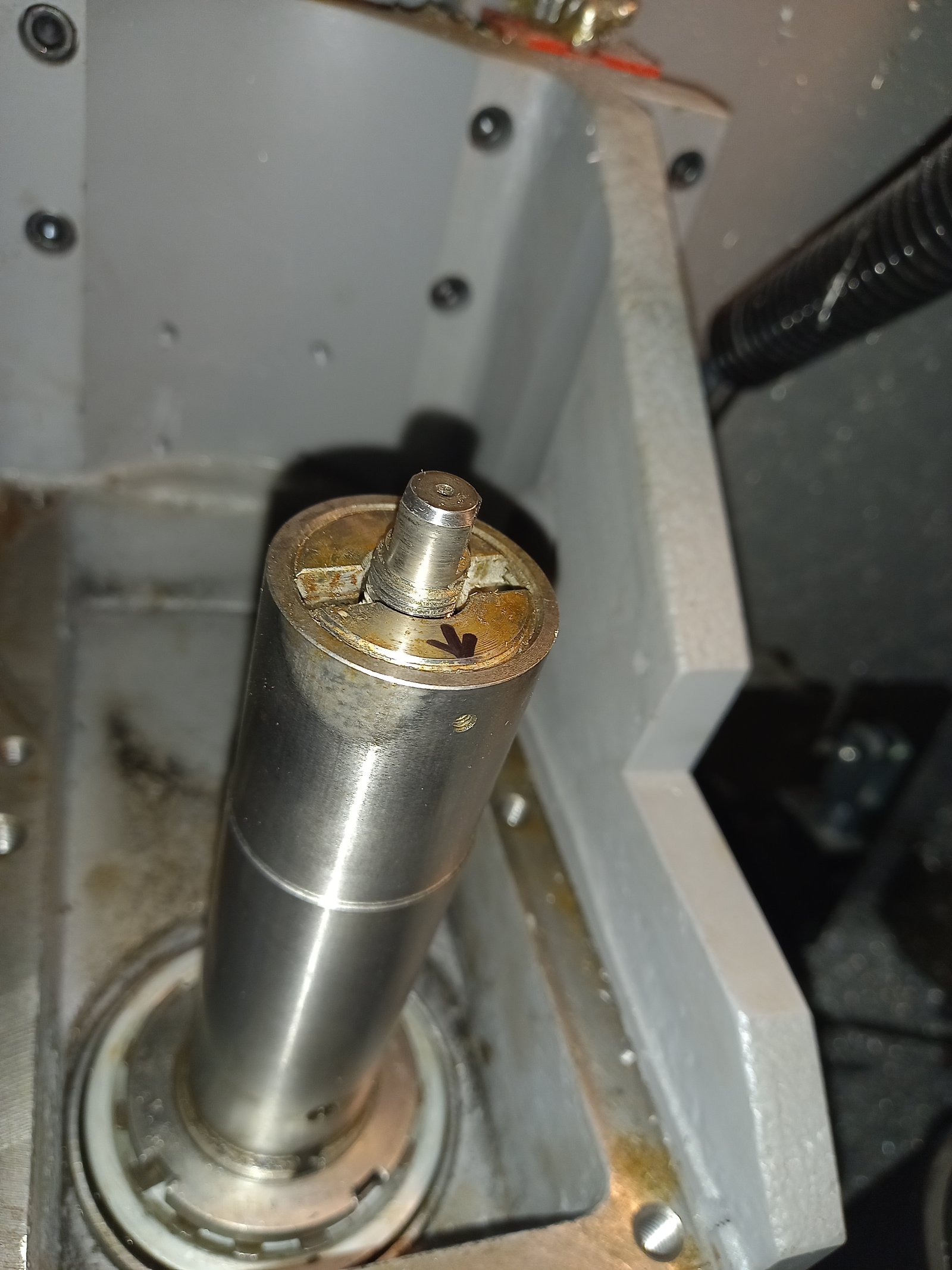

Update on my spindle bearing noise, with advice from Steve at Denfords I have now changed the main bearings and after the first run it seems to be nice and quiet.
It took a week of careful work, made a few special tools and pondering how tight the bearing tension nut should be , as it will take a few hours to
get at it for adjustment if I have got it wrong.

Post by johnparker » Mon 24 Mar , 2025 17:19 pm
