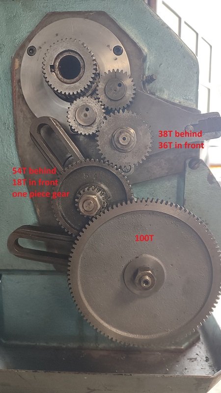

Recently, I had a need to make thread and the subject really fascinates me I tried to understand the gears table on the lathe
part of the understanding process was through this forum, but I had a small gap in my understanding of which gear is actually being replaced
It should be noted that the lathe was given to me without spare wheels but I will get what is required
For the sake of explanation, I tried to make 1.5 mm pitch thread. I understood from the table that I need to put the handle and the counter on 1 ,64 gear must be installed and right turn
I understood that the wheel in the picture should be replaced with a 64 wheel, at first glance I don't think there is room for this wheel. What am I missing?
I would appreciate any help and assistance
Lior

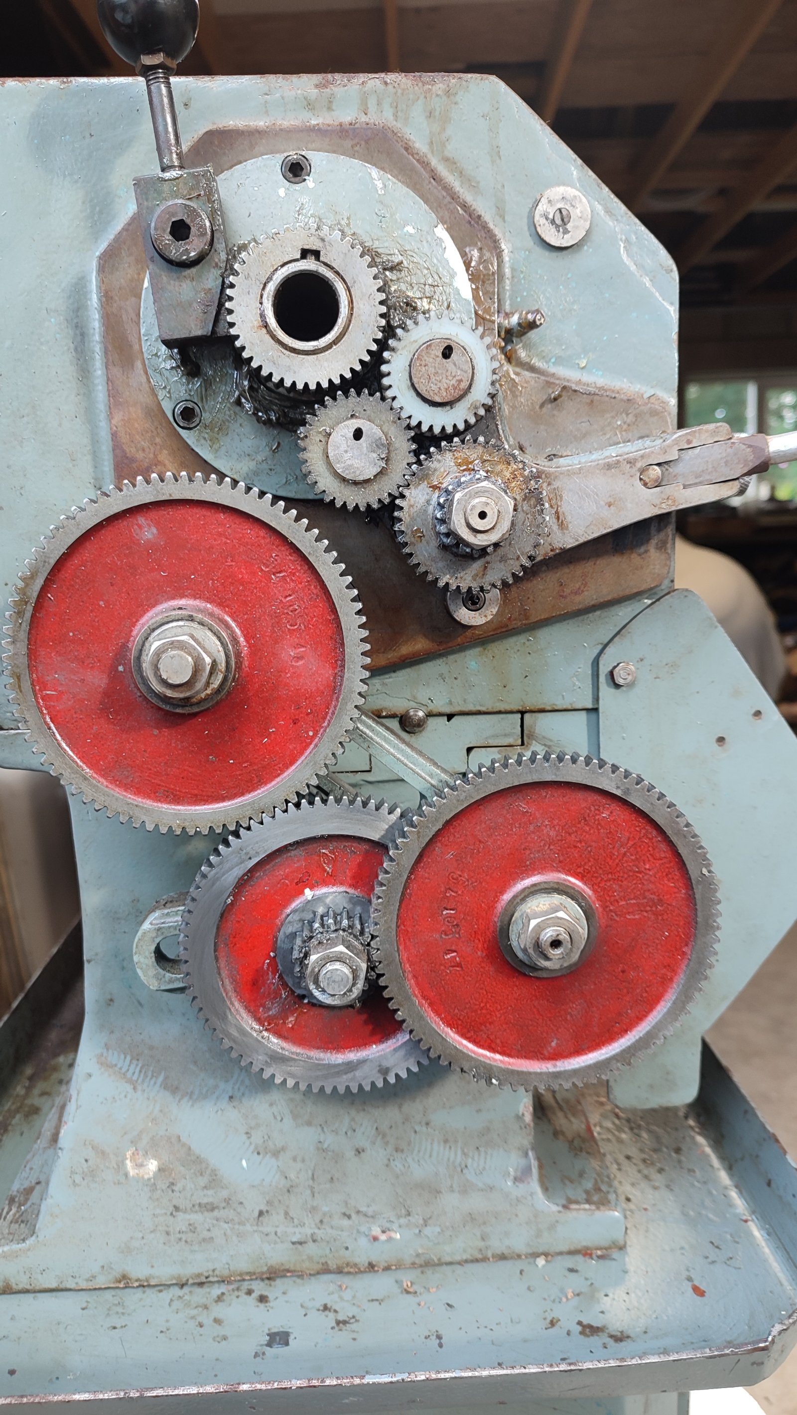

Bit hard to see from your picture (or the picture you found?), but my (old) Viceroy (imperial) had this arrangement:
Is your lathe metric or imperial? If imperial, you'll need a 127T gear to do metric threads from recollection, search on here for 127T and I'm sure you'll find lots of threads etc.
Different lathe (my current one!), (still at TDS1) different gear arrangement (not engaged)
On the bit where it says 54T 18T there are 2 sliders which allow the gears to move on a slider so smaller gears move closer, bigger gears move further away, and the whole arrangement moves on an axis to ensure alignment.Is your lathe metric or imperial? If imperial, you'll need a 127T gear to do metric threads from recollection, search on here for 127T and I'm sure you'll find lots of threads etc.

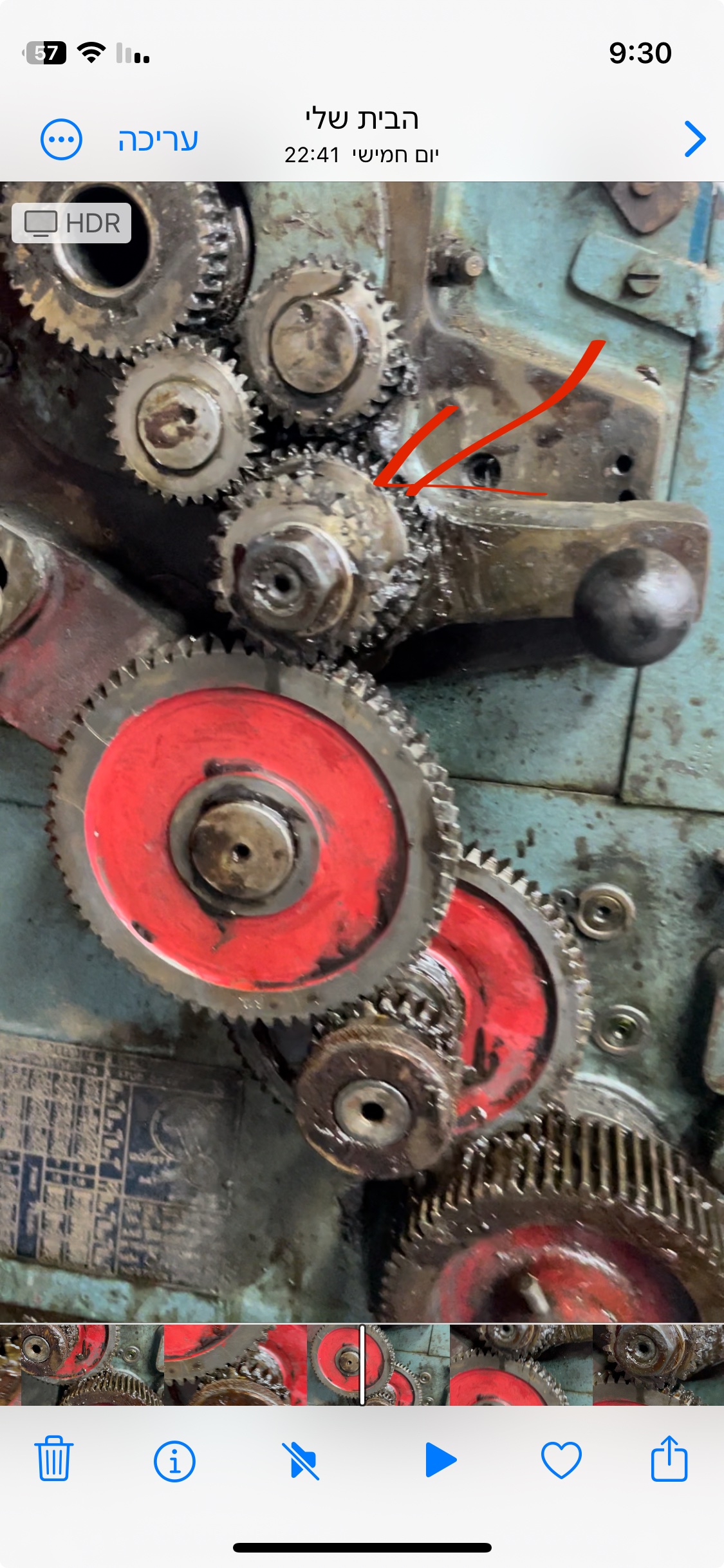

From my understanding the Stud gear is the outer one of the cluster you pointed to in red, the inner is an idler. The top 4 gears in your pic are the drive from the headstock, the two reversing direction gears and an idler.
