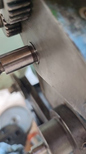

Stud Gear shaft with rotating aspect proud of the lathe body.

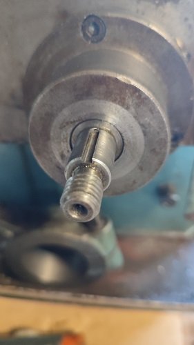

Screw gear shaft with bush fitted. Bush touches and rotates against lathe body

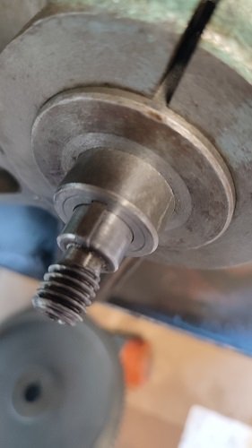

Screw gear shaft pushed towards the lathe body

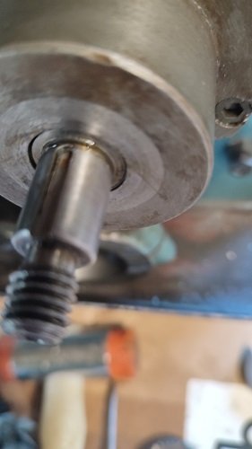

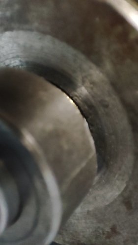

Close up showing where screw shaft bush has worn against lathe body
