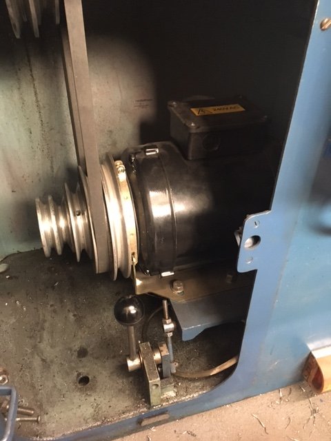

I did the conversion back in 2006 - does not seem that long ago !
I don't understand what you are saying about single pulleys - I have just replaced the motor using the 5 speed pulley originally fitted (4+1 for coolant if fitted).
Mine is the CL750 with 1 horse power DC motor - looking at their website the AV750 looks virtually the same.
It realy has transformed the lathe - mine had a single phase unit before that was really underpowered. I now often just select one pully size and it copes with quite a lot of situations only altering pulleys when required. The variable speed is excellent and for shorter periods you can extent the lathe rev range by running below the recommended lowest continuous motor speed especially with lighter cuts without overheating.
Newton Tesla were very very helpful and friendly to deal with and suppied the motor to fit the pulley and footplate to suit the original frame size.
My lathe has the air kick stop emergency brake at the base and I wanted to keep it so they added the necessary wiring to allow me to keep it. I removed the original lathe door switches mine had as I didn't want them. The Jog feature is really useful when setting up and checking the work out prior to starting up.
I would speak to NT and see what notors they can offer these days.

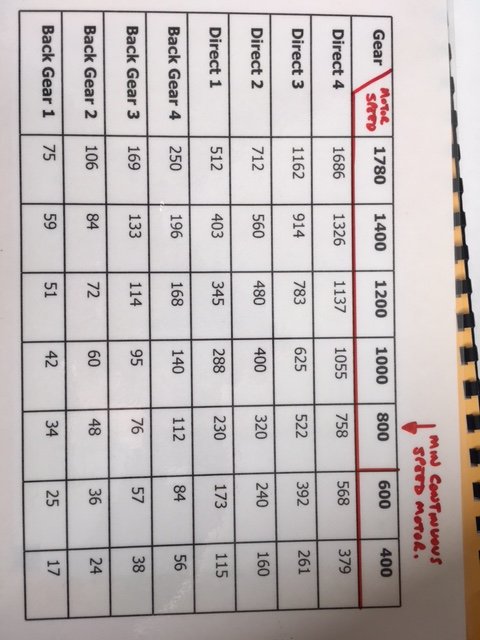

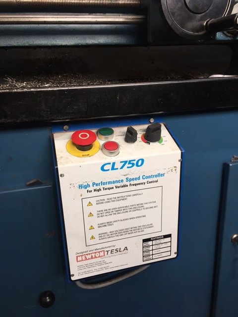

I've attached some pic's and a copy of my motor speed chart I made up.
Richard B.

Forgot to note that the torque is pretty much constant and whilst I've noted the speeds at set motor rev ranges it is obviously continuously variable through the rev range.

Hi Richard I`ve just had another look at your pics as I was wondering where to mount the control box for the VFD. I notice yours looks to be over the motor door - do you have to remove it to access the motor - just thinking of if you need to change the belt position ?
I have ordered the AV750 with the B56 motor frame which I`m told is the same mounting etc. as the standard motor I`m about to remove.

Mine is mounted to the side of the motor door so no problem opening the door - just the angle of the pic.
It covers over the opening where the old control panel was mounted.
Can't find the details of what I ordered just now but I did check and specify the shaft diameter.
My old motor was the original Brooks and Crompton one.
If you need any more info/pics let me know.
Richard.

Forgot to say - the speed chart looks great I shall certainly do the same as its very useful. As you said I would imagine you can set your belt some where in the mid range then use the VFD most of the time so eliminating a lot of belt changes.
