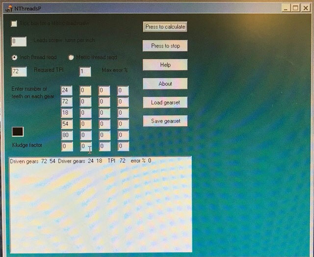

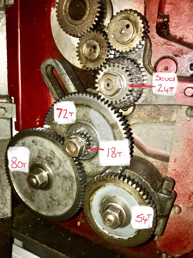

Thank you for your help I downloaded the program and I thought I’d start by what was left set up on the lathe from the last owner. it looks like he was trying to cut a 72 TPI thread here are the pictures of the gears. I’m trying to understand when the program tells me what gears and where the gears need to go. But for some reason the 80t gear dose not show up as being needed in the software.I don’t understand the difference between the driver and driven gears
Does it matter which way round they go my guess would be if the 80 tooth and 54 teeth are the opposite way round you still end up with the same result or am I wrong.
Ok I've add a picture that explains the D gear 80t. But the software suggested order is not the same as my setup, dose this matter

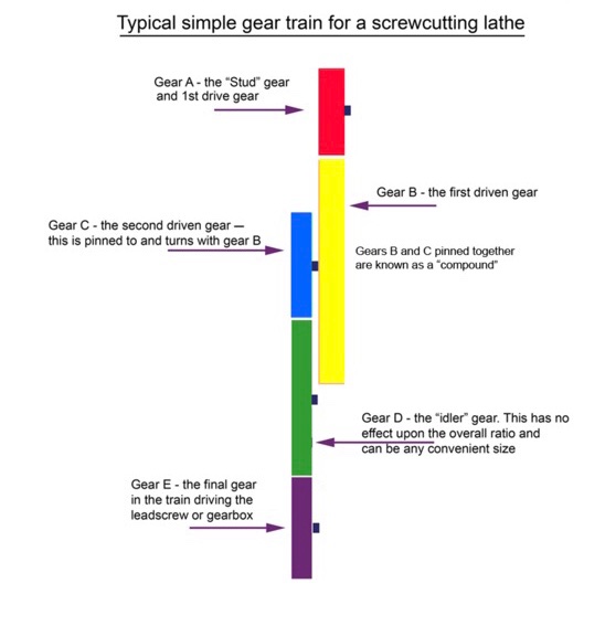

The driver gears are any gear that drives another. The driven gear is any gear that is driven by another. Any gear that both drives, and is driven is called an idler. Idlers are just space-fillers, you can fit any size gear so long as it fits in the space available.
In your pic the 24T Stud gear, the 18T gear are drivers, The 72T and 54T gears are driven, the 80T is an idler.
In a simple gear train ONLY the first and last gears, plus any compound gears count towards the ratio. So you can't change the first, the last or the compound without the ratio changing.
That said, you CAN move stuff about if you follow some simple rules:
Any driver can swap places with any other driver without the ratio changing.
Any driven can be swapped with any driven without the ratio changing.
Any driver can be swapped for a gear with a different number of teeth PROVIDED that any driven is changed by the same ratio, without the overall ratio changing. This would be handy if for instance you didn't have a 54T gear, but you did have a 72. You could use the 72 instead of the 54 as a driven gear (54x4/3=72) so long as you applied the same ratio to any driver i.e the 24T stud gear (24/3x4=32) would be changed by fitting a 32T stud.

The first driver gear doesn't seem to be taken into account, the one on the end of the lathe spindle and the 28 tooth? forward/reverse feed? intermediates directly after it before the stud gear, they will effect the overall ratio. The lathes.co.uk information does call the gear on the end of the spindle a stud gear. I suspect the first drive gear on the end of the spindle and the intermediates just after it aren't shown on the gear set-up diagram as they likely can't be changed. Just noticed the other gear behind the 24 tooth stud gear, how many teeth does that have? Just thinking if the gear behind the 24 tooth has the same number of teeth as that on the end of the spindle then they would cancel out and the 24 tooth stud gear would be the first in the chain so need to check those other gear numbers.
Re: Viceroy TDS1 PCS
Pretty sure that on the non-gearbox models the spindle gear and the gear behind the stud gear are similar tooth count. The gearing chart in the pic above certainly suggests so.

I’ve just checked and yes The gearbox gear has 38 teeth and the gear behind the also is 38. I’m not too sure why am so concerned with cutting my threads in metric as it will probably be easier to use taps and dies and for anything larger so long as the two parts I make have the same thread I don’t suppose it matters if that’s Imperial or metric. Thank you for everybody’s help and now understand what the program NthreadsP is telling me. Hopefully
An error of %0.7 should not cause took much problems.
I guess it’s time for me to play with the machine Anna and try and make a wobble Engine my first project. Or would you guys suggest anything else for a beginner.
