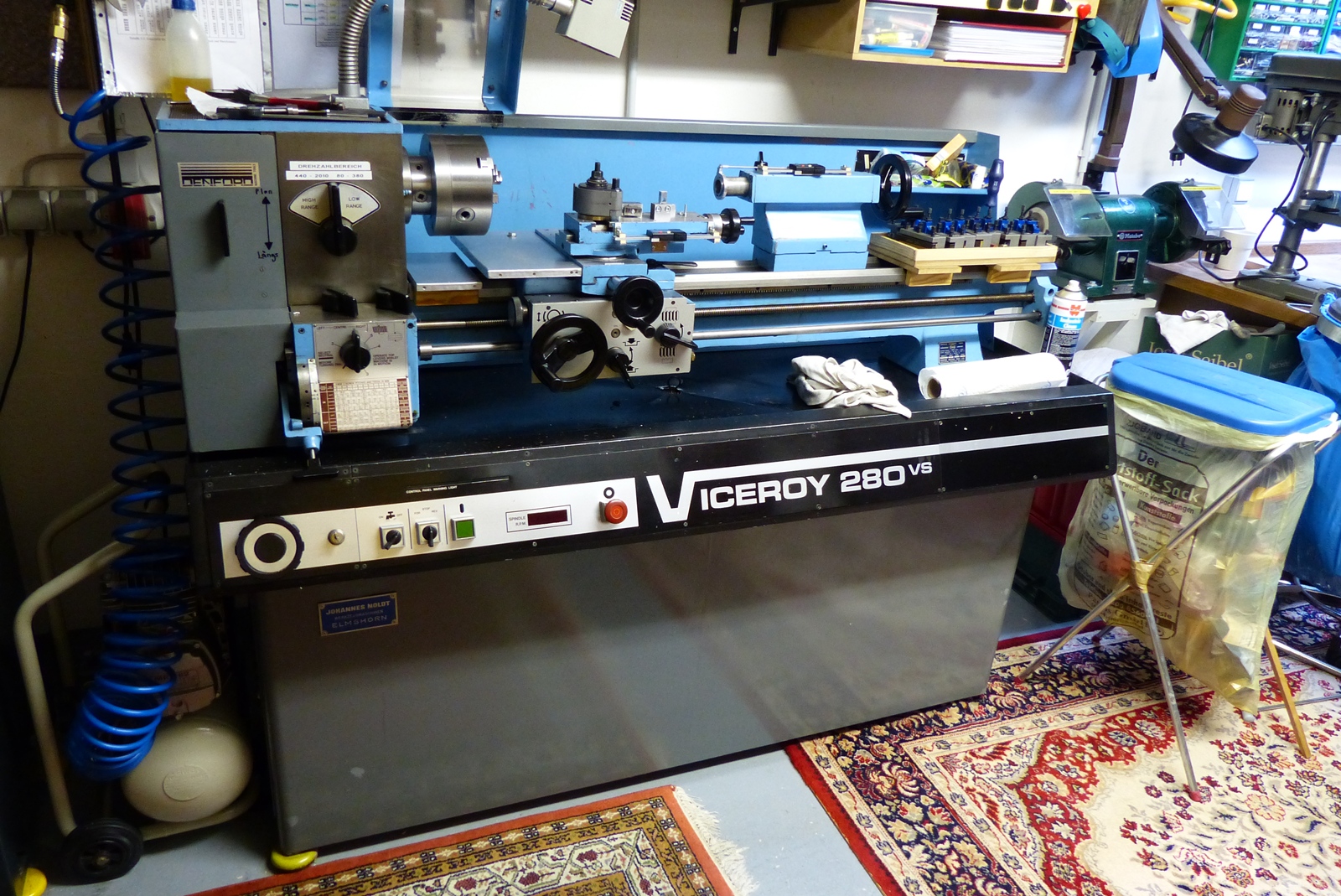

Hi Guys and fans of the vintage Viceroy 280 VS lathe.
I am new in this forum and a model engineer since many years. I am from Germany.
In 1984, I purchased a brand new metric Viceroy 280 Manual VS Lathe from a big tooling shop, the version with the down-drive block mounted in the cabinet and speed control by hand wheel and long bed of 1 meter.
Copy of the original brochure and probably actual picture attached.
I use it now since more than 30 years and it looks and works like new. Also, it is fitted with probably all available attachments incl. imperial transposing set.
Unfortunately the machine came from the factory with a wrong set of drawings. they are for a Viceroy 280 VS with Top-rive and Joy-stick. Also, the gear wheels for the imperial transposing setup came with the wrong drawing for the metric setup.
Also, the date of manufacture is not stated on the name plate. I guess around 1980/81 ?
The Serial Number is 24917, some drawings mention 1980 as the latest date.

Welcome to the forum. If you can get answers to your questions, it will be here! Firstly I'm immensley impressed with the immaculate condition of your lathe, plus a carpeted floor in a workshop! They look like nice carpets too!
