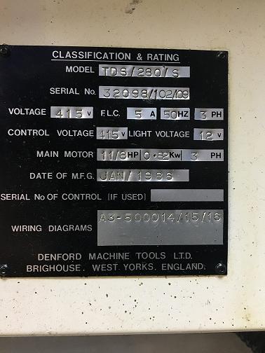

I have recently purchased this 280 synchro. It has developed this issue of the contactor vibrating on and off. I have identified a small relay on the board that seems to control the main contactor in the control box, that seems to be alternating on and off. I have taken its cover off, forced it on and everything works fine but unfortunately it doesn't stay on! I have taken a picture of the label on the control box. I have had a look on the forum but I have not been able to find the right wiring diagram for my lathe so I wonder if anyone is able to provide one or help with this problem.

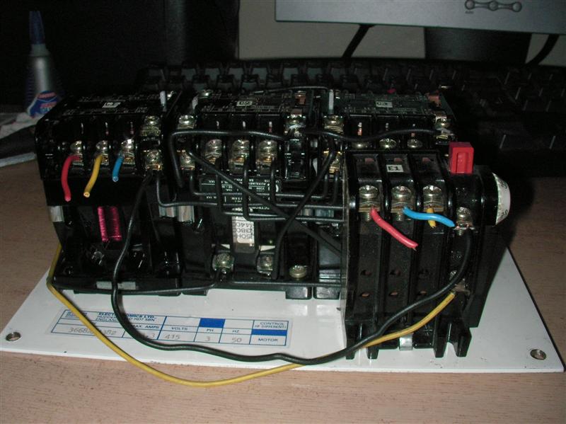

I just noticed you said a relay controls the contactors, Mine didn't have any relays the buttons acted directly on the contactors themselves. Here is what I had in my Synchro.

The contractors you picture are not the ones I have an issue with. There is another control box under the bed which has a pcb with 4 relays on it ( one of these is the issue), two transformers and two contractors.

My machine didn't have any such PCB, and it doesn't seem to be shown in that wiring schematic Andy posted. I wonder if it is part of the optional DC-injection braking system, or perhaps something that was added on later machines, or maybe your lathe was once a combination lathe/mill variety?
The only thing that I found inside my machine was a small vacuum switch type device which was disconnected.
