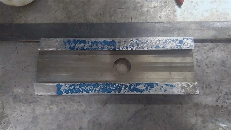

I'm working my way through this TDS1 and I noticed that the cross-slide seemed to rock a bit so I set it on my surface plate to check it out. Sure enough it's got a 2 thou belly in the underside, and added to that the compound slide rocks on it's base so I guess the thin casting has twisted a bit over the years. Here's a video of the problem
https://www.dropbox.com/s/7hz4thfmll8dx ... e.mp4?dl=0
So I'm busy rough-scraping the slideways flat and then I'm going to attack the compound slide seat. I did try to fit it up in my 4-jaw and turn the compound but it's just too long to swing in my lathe, so it'll have to be scraped all the way.

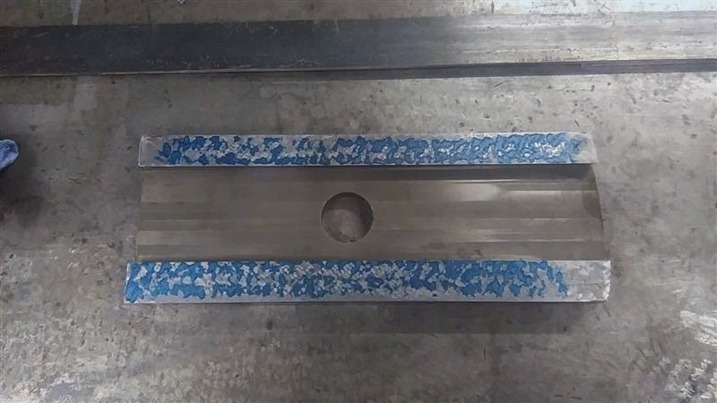

Here you can see the ways were only touching in the middle, not surprising given whet we saw in the vid

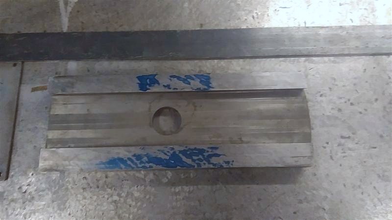

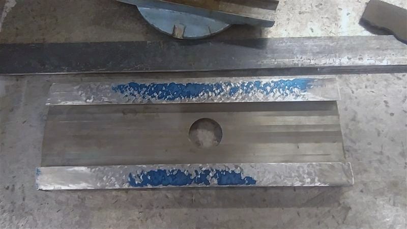

So I have at it with the Biax power scraper. It would have been possible to take the large amount of metal off with a hand scraper but that would have taken a long long time - typically you scrape 0.0001-0.0002" off at a pass so here is the result of about a dozen passes with the Biax.
And here we have a fairly flat slideway. There's a dip right at the end which I'm not concerned about. Just like it is it's better than 90 percent of the machines out there. I'll rough in the top where the compound sits and come back to this later, in case it moves when I'm taking the top down flat.

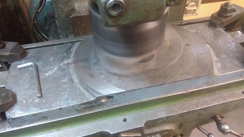

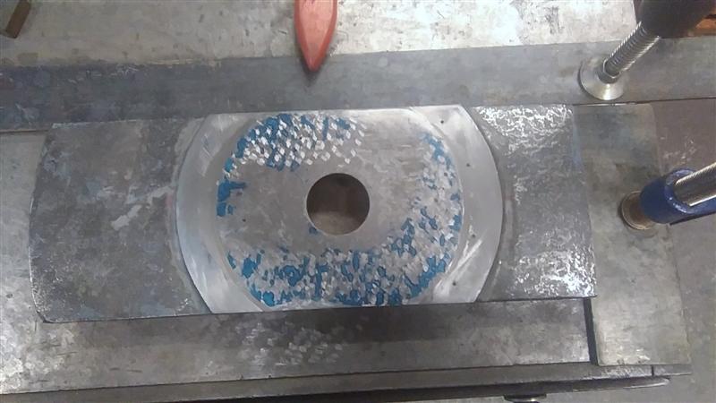

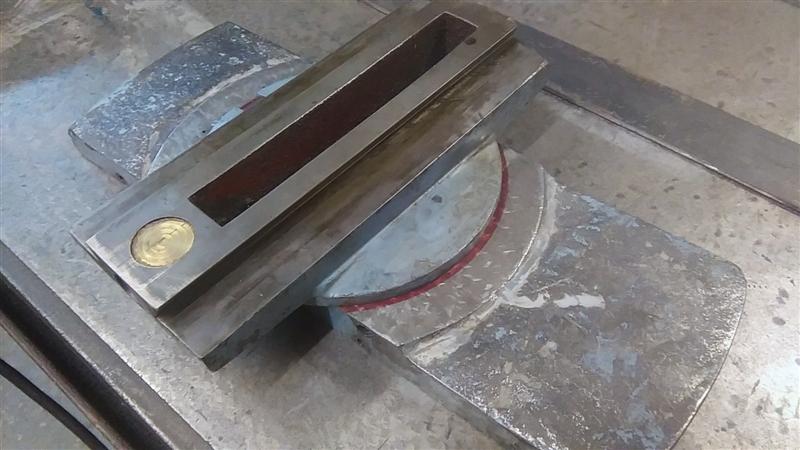

The top of the cross slide was no better. First problem I had was that it was printing outside the area that the compound base sits on and I didn't want to scrape all that down so I set it up in my mill and fly-cut those bits a couple of thou lower.

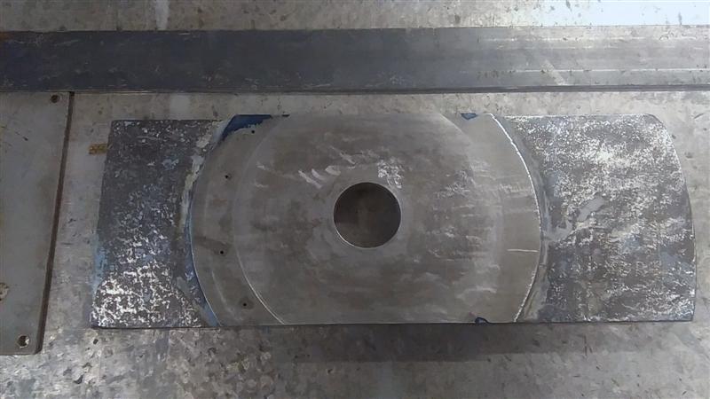

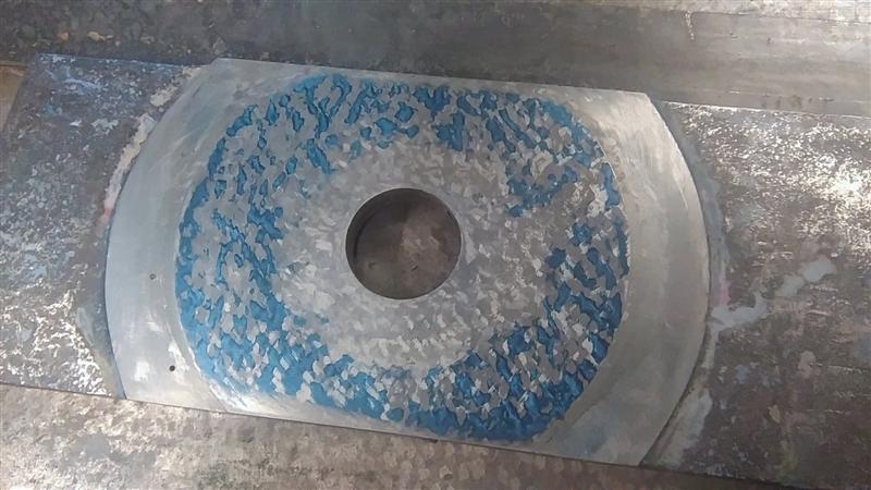

Then the main cause of the rocking compound became apparent. There was a raised hump above the end of the wedge-hole, probably the result of a minor tool-to-chuck interface.

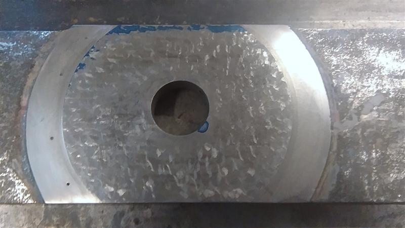

So I scraped that whole middle section low in a wide circle to prevent it ever causing the compound to totter on a raised bump again.
Much better now. The compound sits down flat and it will make the machine a lot less prone to chatter and poor finishes.

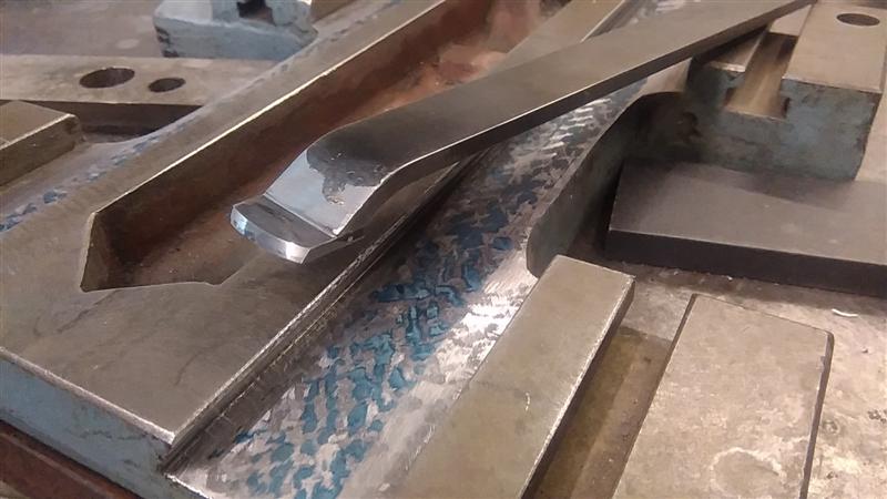

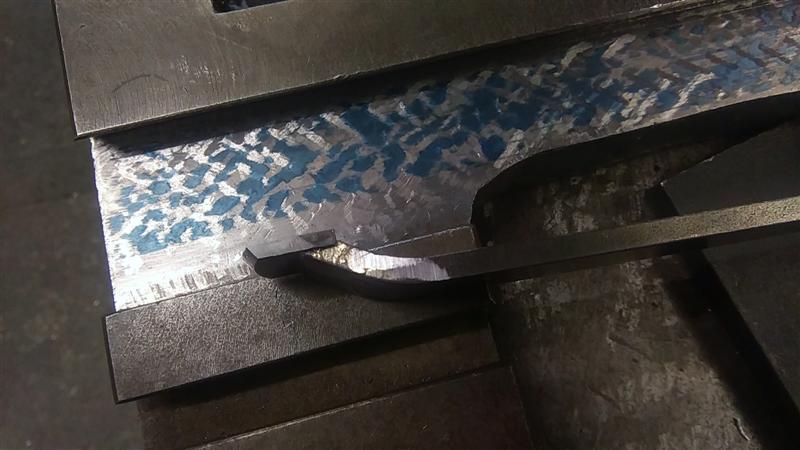

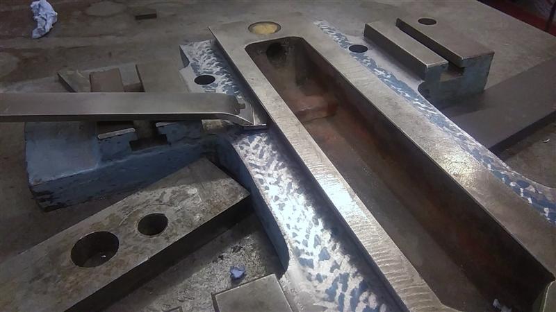

Today I had to make a custom hand scraper to scrape the cross-slide ways. Came out pretty well and I have the ways nearly done.
