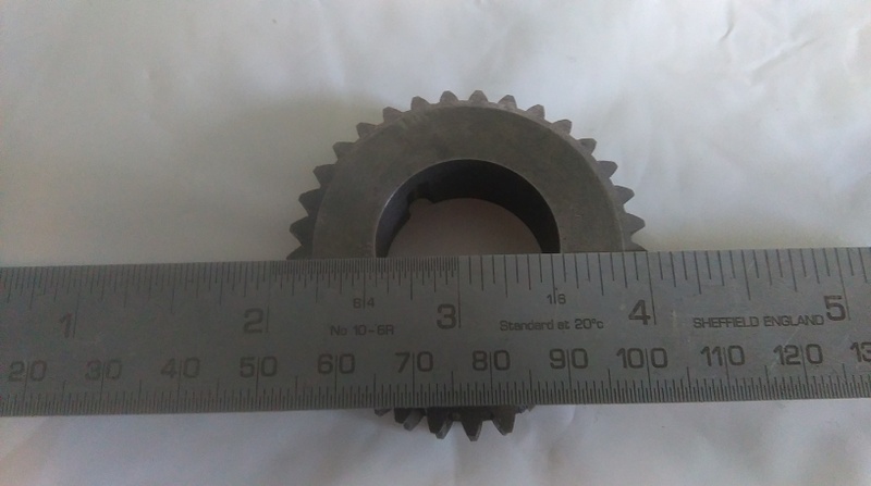

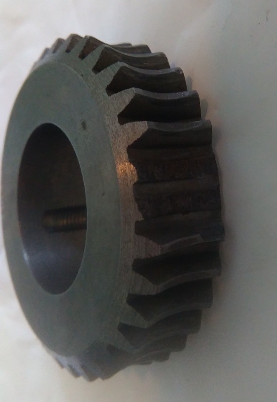

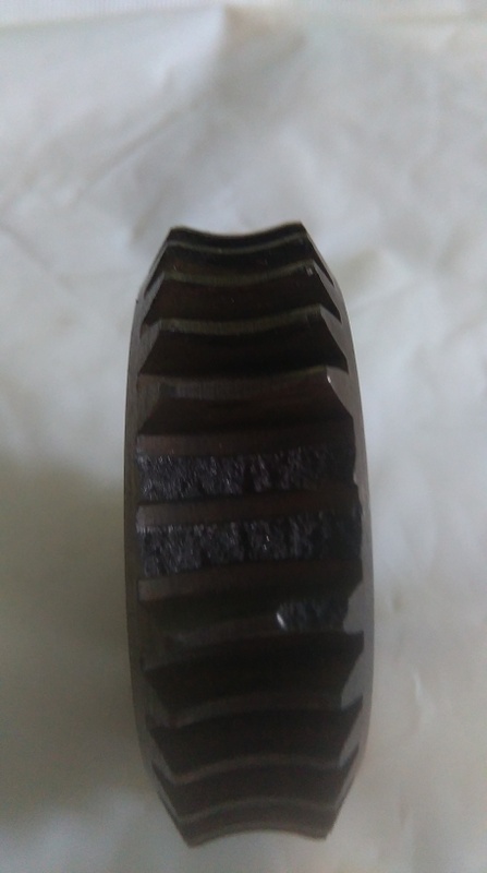

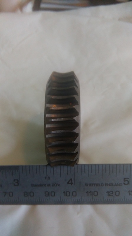

2 teeth mullered on one gear,
Gear is 2" dia, with 33 teeth ( 31 at the moment ) 5/8" thick , 1" dia hole which keys on to another gear with grub screws
and the teeth seem to be set at an angle of ~3 degrees , it's the first gear off the worm drive - left handed
Let the search begin!
Any thoughts for potential suppliers please let me know
After some further investigation, it looks like the gear picked up on the running shaft and seized up causing the teeth to strip.
Shaft is a bit of a mess, so will probably make a new one out of bronze assuming I can get the gear remade at a cost that is less than what I paid for the lathe

Re: Apron Removal from a Synchro 280
I make that 18dp based on the photo with the ruler.
I'd have a go at pinning it and building it up with braze then hand-finish to shape until I could find a replacement or a cutter to make one.

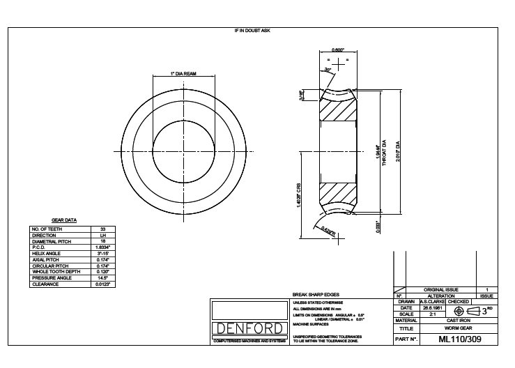

Here's the drawing for the gear.
You weren't far off with your dimensional assessment
Sorry about the colours in the pdf - that's how I got them! I haven't yet found a way to make them any more readable.
- ML110_309.pdf
- ML110/309 worm gear
- (46.09 KiB) Downloaded 970 times
Andy here's the drawing as a PNG, I don't have the driver installed here to print it as a pdf.
- ML110_309_apron_worm_gear.png (47.06 KiB) Viewed 27300 times

And many thanks from me to Andy B for that apron drawing - it looks identical to my 250 apron, and I was wondering exactly where the two washers I had left over had come from.....
