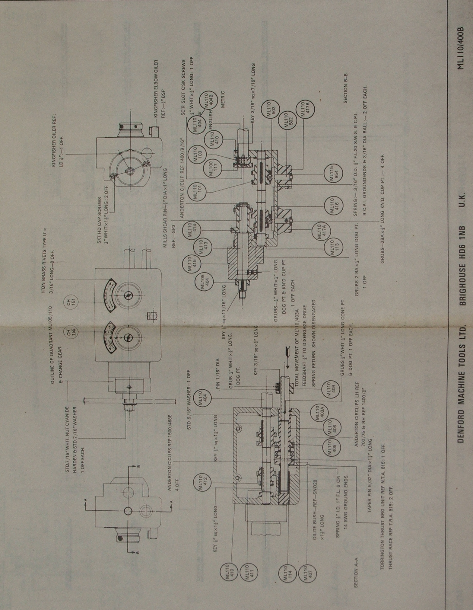

i will try and upload the rest of the drawing today, hope they are of some use, this is No 21.
