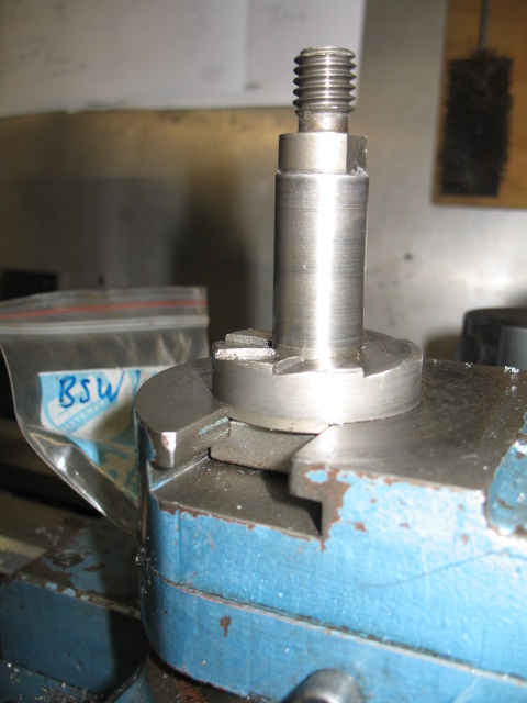

My Denford tool post is bolted into a wide T slot as seen here.
It makes it a versatile and rigid mount.
As far as I can tell, this looks identical to the Boxford.

I think the problem with fixing it on the topslide instead of the toolpost(which would be very easy), is that it would make the vertical very high relative to centreline, and I'd have doubts about how much useful milling could be done on it. A lot depends on the size and type of work the OP has in mind.
The Denford vertical slide looks to have been made to fit on the cross slide in place of the topslide, which would be quite a bit lower.

I just took the topslide off to check and there is a spigot protruding from the cross slide as you say, so the Boxford vertical slide would not fit.
From what I understand, the vertical slide needs to be extremely rigid for any serious atrempt at milling, so attaching it via the T-slots on the topslide might not be sufficient, but I may be wrong.
That leaves the options of either finding an old Viceroy vertical slide (unlikely) or making an adapter plate for the cross slide. I will investigate the latter option and report back.

OK, I see that the Boxford and Denford have different spigots on the bottom of the compound.
