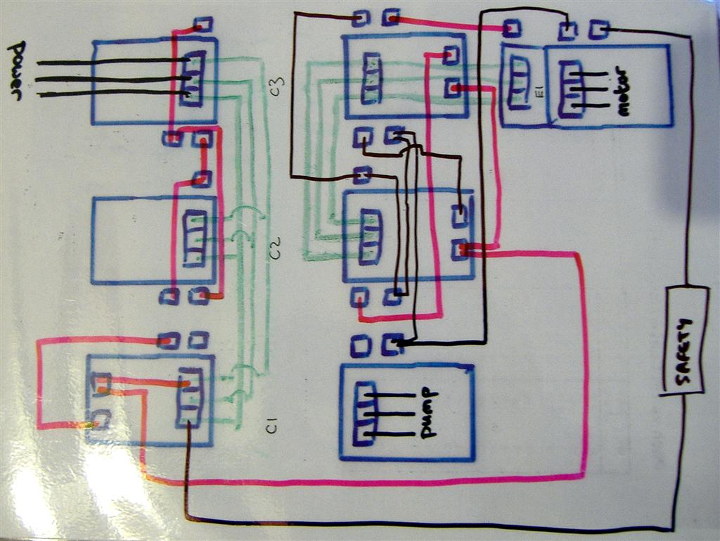

Seems pretty clear to me that the door switch is faulty. Join the wires to test it.
If it does happen to be something else I have here the wiring mapped out for the gang of three contactors (fwd, rev and pump) on my synchro.
- 3phasewiring.jpg (114.53 KiB) Viewed 13627 times
