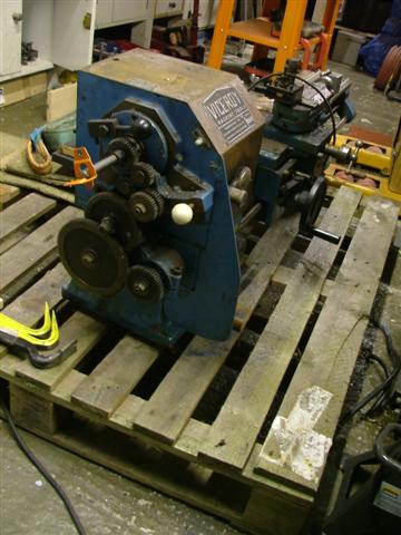

Here are a few photos of the viceroy TDS 1/2PCS (converted to single phase with a 1hp GEC motor & a Dewhurst reversing switch) lathe that is the aforementioned for rebuild plus the work done so far on the cabinet that was well rusted and has been stripped back to the base metal and primed.

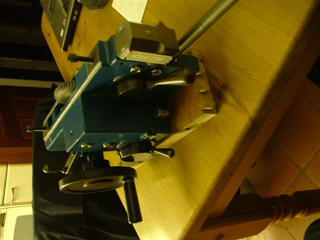

Dazz, is the saddle selection lever you mentioned that selects the saddle power feed and the cross slide power feed in photo DSCF1326.jpg?

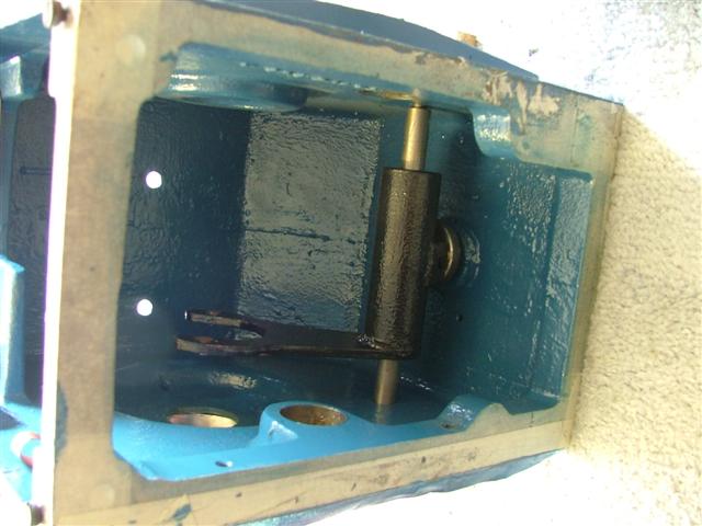

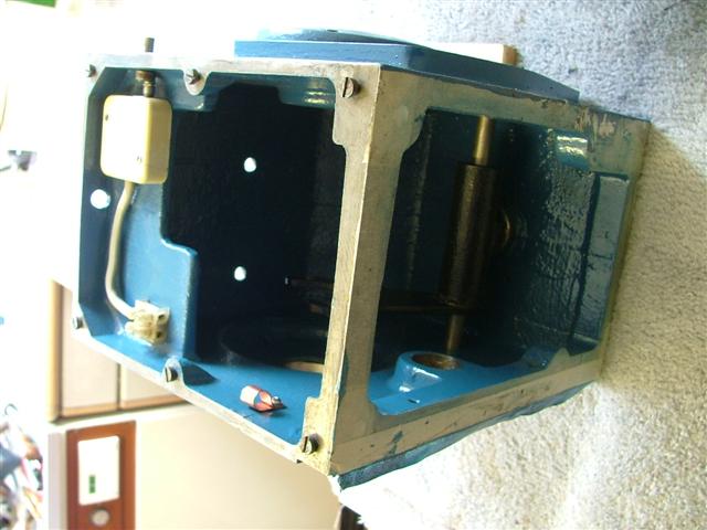

- Restoration work in progress to repair original kick switch.
- DSCF1324 (Small).JPG (26.3 KiB) Viewed 24537 times

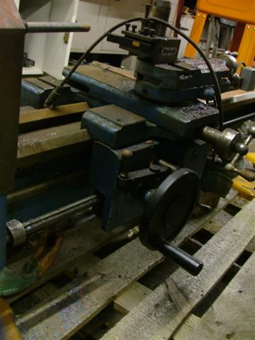

- Feed selector lever on saddle query.
- DSCF1326 (Small).JPG (37.07 KiB) Viewed 24537 times
- Viceroy TDS 1/2PCS lathe as delivered

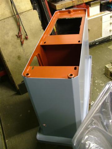

- Lathe cabinet restoration to primed state, note slotted motor base plate holes modification to allow better pulley alignment.
- DSCF1328 (Small).JPG (33.18 KiB) Viewed 24537 times

Yes, you have powered cross feed. Not a feature you would expect to see on a stripped down basic model.
While you have the cabinet stripped to bare metal, you should check/redo the welds. If yours is like mine the welding is not that good.
Nice photos. Keep them coming as you progress.

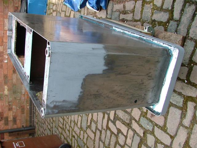

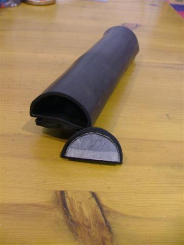

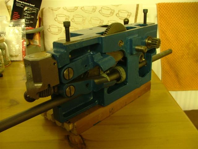

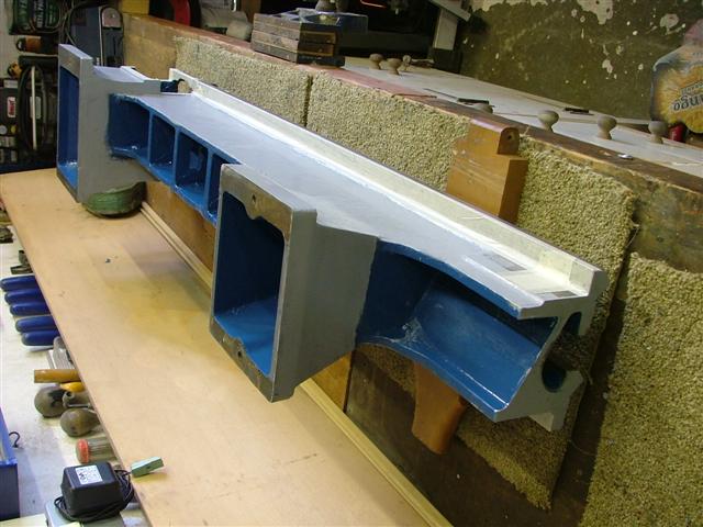

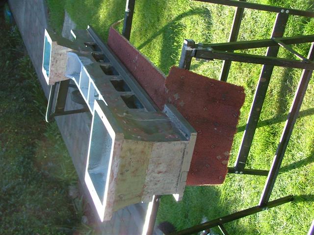

Hello to you all,

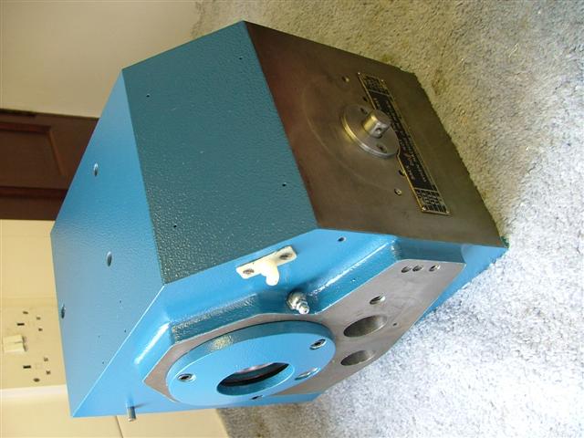

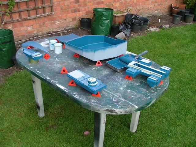

Here is some updates to the renovation work to date with photos. The lathe cabinet is now fully restored and painted. The paint used is a 2 part epoxy marine quality paint by Sigma coating (Ral 5009 colour)and is not quite the same shade of blue as originally used by Denford. The finish is is satin finish and has been applied by a foam roller for gloss paints so has a dimpled effect That I hope is most durable.
The whole electrics have been stripped and rewired to industrial standards and a rotatory isolator fitted. The saddle, carriage, bed, cross slide, top slide, & tail stock have all been stripped and cleaned down to bare metal renovated and repainted.
Photos are below to illustrate some of the work done to date that may be of interest or inspiration to other members.
Kindest regards, John R.
- Renovation of Saddle & Other Parts
- SaddleCrossSlide (Small).jpg (77.82 KiB) Viewed 24459 times
- Renovated Carriage Controls
- RenovatedCarriage01 (Small).JPG (44.59 KiB) Viewed 24459 times
- Renovated Carriage Gear
- RenovatedCarriage02 (Small).JPG (45.83 KiB) Viewed 24459 times
- Lathe Bed Internals painted
- LatheBedPartPaint (Small).jpg (61.62 KiB) Viewed 24459 times
- Lathe Bed Prep for Painting
- LatheBedPrep (Small).jpg (77.82 KiB) Viewed 24459 times

Hello to you all,
Just wish to thank Denford admin for their appreciation and encouragement to keep these topics updated.
The latest update on the rebuild is that the lathe bed painting has now been completed and has been fixed and leveled on the lathe cabinet. Leveling was achieved using a 10inch precision engineers level taking note of comments made by Dazz.
The tail-stock and feed gearbox renovation has also been completed and the saddle re-assembled and mounted on the bed. I have spare saddle clamp should anyone be in need of one, please PM me if that is the case.
Photos of the current rebuild state are to follow when the headstock has been renovated. The headstock speed change assembly is seized rock solid and I think the headstock will have to be removed to gain access. Further updates to follow.

Here are some more photos that might to be of interest; this time the headstock renovation showing the freed off gear speed selector & the rewired gear cover trip.
The lathe renovation is now complete and I have a working lathe. Will post some other photos of the restored lathe at a later date.
Kindest regards, JohnR.
- Headstock Externals off the Lathe
- Headstock03.jpg (53.8 KiB) Viewed 24159 times
- Headstock Internals Without the Gearing
- Headstock02.jpg (51.65 KiB) Viewed 24159 times
- Headstock Speed Gear Change Lever
- Headstock01.jpg (50.33 KiB) Viewed 24159 times

Re: Denford Vicerory TDS1 PCS in a sorry state _ Rebuild?
And some questions on painting: what exactly paint did you use? Have you got Sigma Coatings product line name or product number? Did you use any primer or just mixed two part of epoxy? How did you paint those complex shapes with the foam roller? Or maybe you used foam roller for large flat surfaces only?
Regards,
Wojtek
Regards,
Wojtek
- CNC Apprentice
- Posts: 48
- Joined: Fri 05 Apr , 2013 0:14 am
- Hardware/Software: Standard PC using Firefox Browser.
Denford Viceroy TDS/PCS version 2 Metric Lathe - Location: Staffordshire, UK
Dear Wojtek,
However, for the benefit of other members, I used a 4 inch (100mm foam roller). You have to make sure the foam type is solvent resistant otherwise the roller tends to disintegrate while you are painting. This is shown up by small parts of the roller coming away and ending up as coloured foam lumps on your painted surface.
A 1 inch (25mm) flat camel haired modellers brush was used to get into the corners/touch up the paint where the roller could not reach.
The paint used was Sigmacover 640 (has to be thinned by about 15% once the epoxy paint is mixed to be able to be used with a roller in my experience) and a metal etch primer was used as all the surfaces where brought back down to the bare metal prior to painting. I used open weave nylon type rotary abrasive discs on an angle grinder for the base and small sized discs of the same type on a die grinder and finally Scrotchbright pads to get into the corners. YOU MUST DEGREASE all the surfaces prior to removing any of the old paint as the grease will just get ingrained into the metal and the new paint just will NOT adhere.!! A solution of sodium triphosphate can be used as a good degreaser, for more information I suggest you search the internet on this subject.
BEWARE the paint/dust, as the removed paint/dust may contain lead and you must wear protective clothing and a suitable mask!! NOT to be done indoors!!
Hope this helps and apologies for the delay in posting as this is the 1st time viewing the site for many months.
