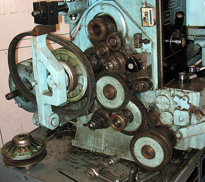

That part you are missing is the tumbler reverse, it should have four gears mounted to it. It's probably been removed because the hardened spigot it rides on (also missing) has a ruined thread. Mine has a ratty thread because someone forced a metric nut onto it though I rescued mine by making a brass nut with the proper thread and there's no real load on it.
See that small cluster of gears fixed to the casing below the pulley - one of them is probably missing, it would have been on that tumbler when it was lost. They are lettered A-G, looks like you are missing the second largest.
here is what you should have:

Hi Pete, thank you for your reply. This lathe came from a school and I believe the missing gears where removed when an attempt was started to replace one of the damaged nylon gears. Sadly this job was never completed and took place a couple of years ago.
The ‘small cluster of gears’ is that the set secured with a wing nut? I’ll check to see if I have a full set.
