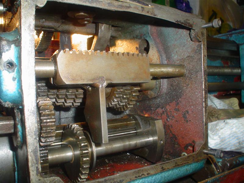

lathe missing shaft and gears what parts do i need
missing gearbox shaft and gears

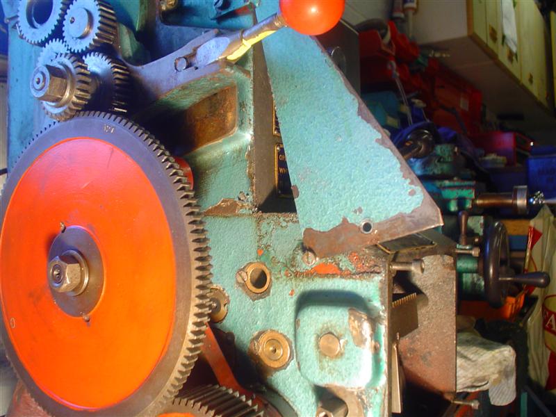

- the lathe resprayed the doors hammered enamel
- viceroy lathe 004 (Medium).jpg (71.31 KiB) Viewed 5085 times
- no gears
- viceroy lathe 002 (Medium).jpg (84.63 KiB) Viewed 5085 times
- missing shaft
- viceroy lathe 001 (Medium).jpg (79.44 KiB) Viewed 5085 times

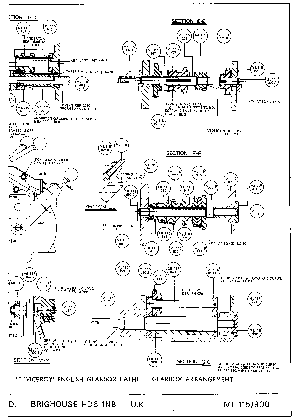

I think you may have a bit of a problem.
As far as I can see you have a slightly different version of the gearbox shown in the scans.
The bits you need look to be shown on section E-E.
There are item drawings available as Pdf's (look for the ML115 section),
but as to how to make or get any of these items,
I think that could be a bit difficult.
Good luck anyway.
Cheers,
Les.T.
PS if anyone can stitch the drawings together that might be helpful

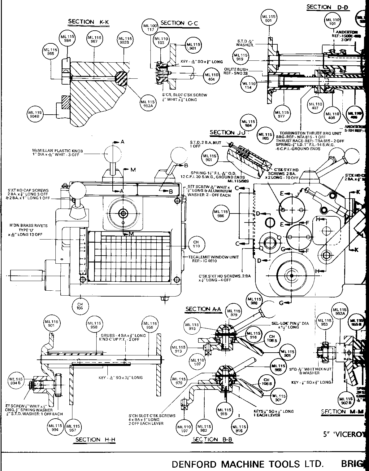

- The other Half of ML 115/900
- scan0002.png (42.23 KiB) Viewed 5068 times
- Half of ML 115/900
- scan0001.png (50.94 KiB) Viewed 5068 times
Re: lathe missing shaft and gears what parts do i need
I've stitched the drawing together and added some more I think are relevant to this thread:
viewtopic.php?f=50&t=2986&p=11420#p11420
