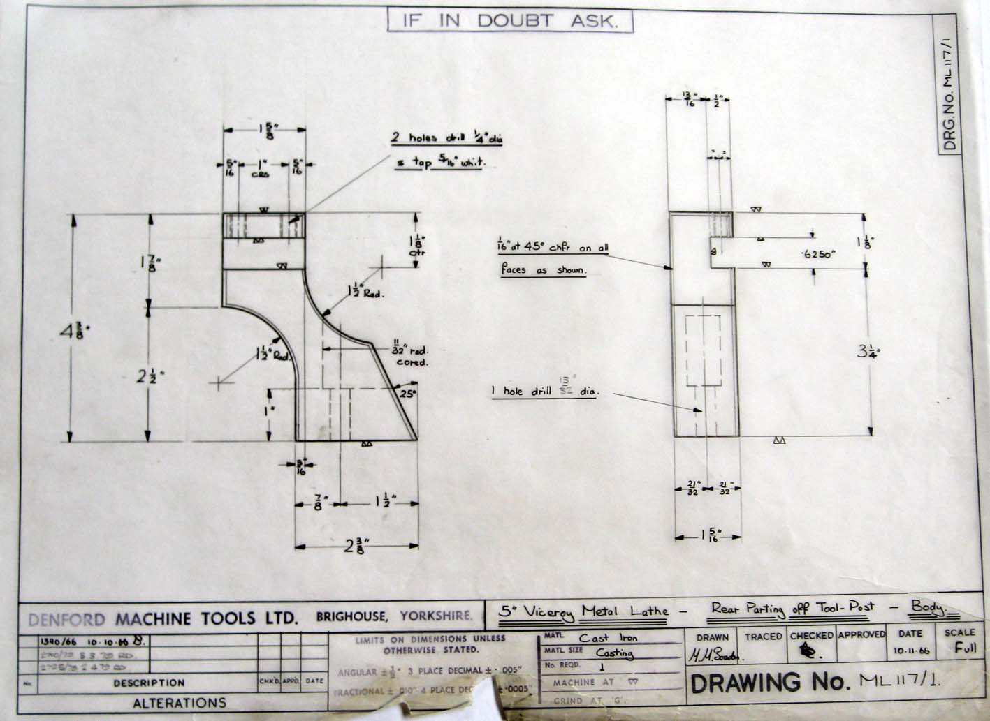

Here is the drawing for the Denford rear tool post machined casting.
I don't have a copy of the assembly drawing, ML117.
Admin may be able to find it.
- Rear tool post machined casting for Denford 5" lathe
- ML117-1#.jpg (126.27 KiB) Viewed 23298 times

Thanks Andy for the drawing.

I was looking at this old post about Rear Tool Posts and saw the drawings which will allow me to fabricate one.
Does anyone know how the Rear Tool Post fits onto the Lathe? A drawing, sketch, template or explanation would help.

Hi Mike,
I believe they fitted onto the T-slotted cross-slide, which was an optional extra on the 5" machines.
They may fit on a 280's too, but I don't recall seeing one in any 280 brochure.

Hi Andy
The T-slotted cross-slide explains it.
I will see if it feasible to make some sort of adaptor plate to allow the mounting of the tool post on the existing cross-slide.
