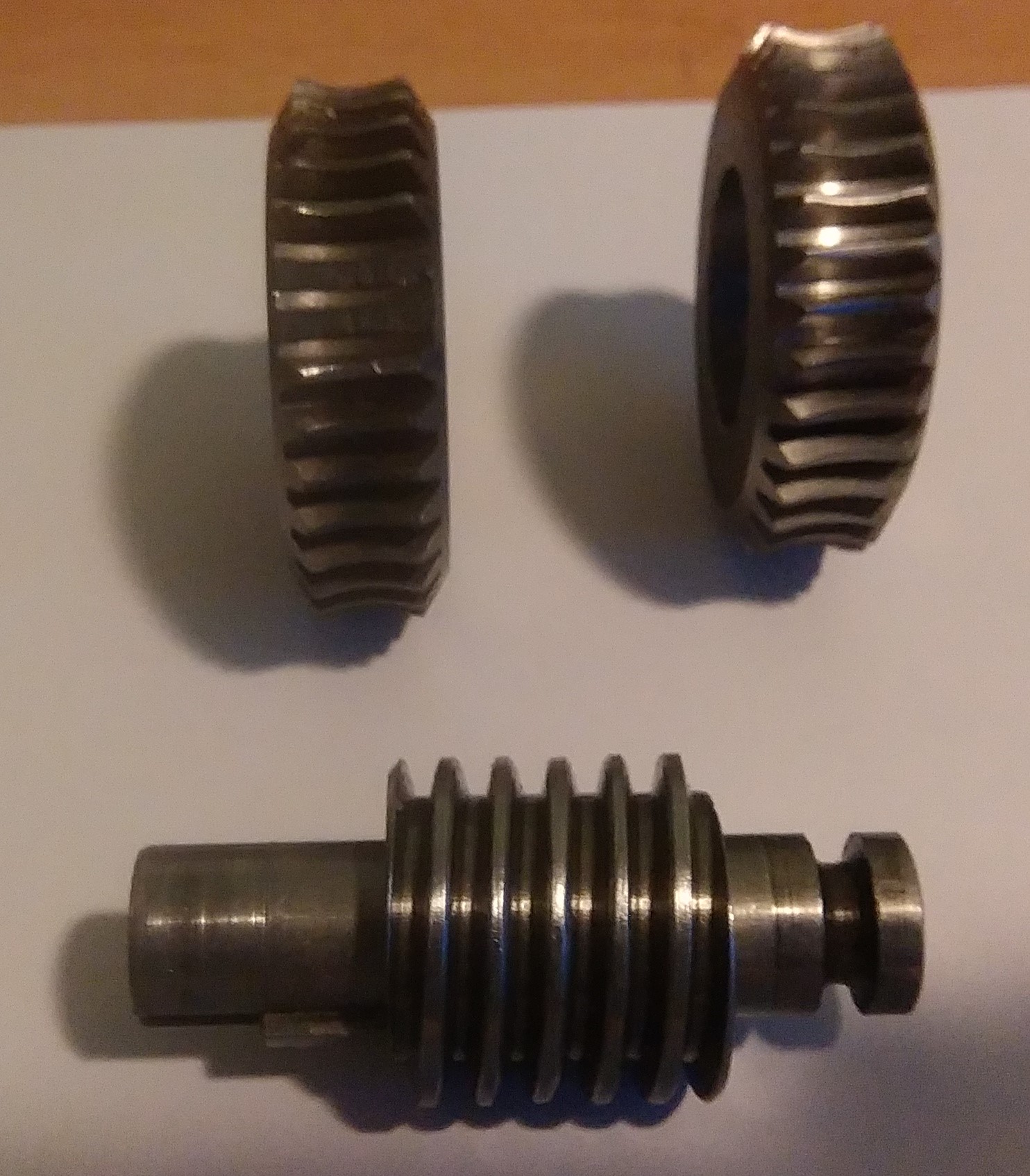

Re: Apron Removal from a Synchro 280
Quick update:
New gear being made via a friend in a model engineering society, should be done by this weekend.
Apparently the new blank came out of a 4" round of cast iron - only material in stock and it was in the scrap bin.
He has also taken the worm gear to redress , so hopefully by the weekend I will not have to pull up the power feed lever
and wonder why the carriage is not moving
New part received, and worm was reconditioned
Fitting on Monday, fingers etc firmly crossed
Gearbox is back together and functioning
FYI: I also found another person who would have made the part, John Ward at Lathespares.co.uk and he quoted £35, he told me he had made some previously
Thanks for all the info and tips
