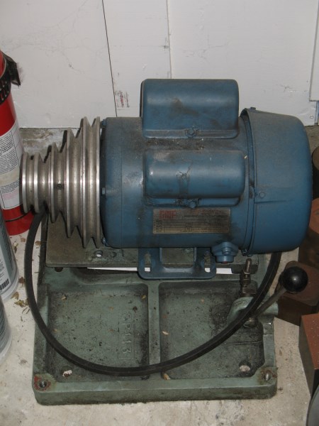

The motor with both cast iron mounts should come out. There is a bolt in each corner of the lower castings.
Here is a photo of mine. Note the motor is rotated 90 degrees from its normal position.
- IMG_4227 (450 x 600).jpg (54.56 KiB) Viewed 22108 times

that looks different to mine...and i have random holes in the floor of the cabinet. I fear it may have been altered slightly.
