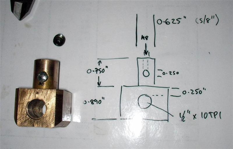

Here you go William:
EDIT: PLEASE DISREGARD THE PREVIOUS INFO.
Basically I assumed that since the dial was marked as .100"/turn and the screw thread was .500" OD they must have used an imperial screw. TUrns out that four turns of the dial moves the cross-slide 9.98mm so now it looks like we have a screw with imperial OD and metric pitch. It COULD be that a 1/2" x 10TPI nut would work but right now who knows. All you can do is measure your screw OD with a vernier and then try to measure the pitch too or take a chance and buy a tap from RDG for a tenner and make a test-nut from ally. If it winds on the thread of the screw then you at least can make a brass one to make the machine useable. I've left the drawing up of my 280 nut as a guide.

thanks very much pete that looks like the part i need is the one in the pic for sale or is it being used thanks for you time to reply to me

It was common on Denford lathes and Tom Senior mills to have a metric pitch leadscrew with and 'imperial' diameter (0.500" dia x 2.5mm pitch) - to keep common first op machining wherever possible.
Pete - I expect your 4turns = 9.98mm is purely down to wear.
Admin - can you scan & post up drawings ML100/512D (cross-slide feed nut), ML100/501 and ML100/501B (cross-slide screws).
I'm not sure which drawings will show english, metric or both variants.

Metric lathe. You need to find someone who can make a nut to that draeing. If you do, I will have one too as a spare - the one in my pic is the one fitted to my lathe.

I think the safest bet is to find a length of cross-slide or compound-slide screw and grind it to make a tap, then use that to produce a nut. That way we can guarantee having the right thread form. I've been on the look-out for such a thing without any luck so far.

I've been looking at this today and my new best-guess is that it's an Acme thread.
https://en.wikipedia.org/wiki/Acme_thread_form
So the options would be, buy a tap or grind a lathe tool to the correct profile. There's a possibility of using a single point tool to cut the trhead, but I'd probably go for making a tool.
When I get some spare time I'll make a rough tool and turn a thread in alu. that you guys can test.
The drawing says 'modified squareform'. The nut doesn't look like it has a square thread hence my guess at Acme.
Perhaps the mod is from 2.54 pitch to 2.5 pitch?
A closeup pic of the leadscrew might prove usefull.
