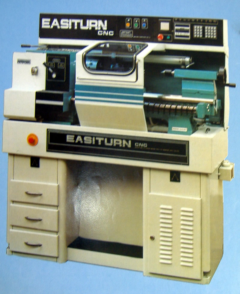

- Posts: 396
- Location: East Midlands, UK
Hard to tell much from those pictures, but it I'd guess at an Easiturn like this one but missing the rear guard and control panel.
It was just possible to make out the back-gear lever on the front of the headstock.
We'll await more info and pictures when you get it home!
