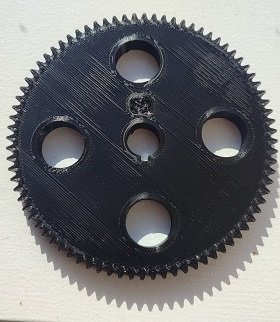

Here's the result of last nights 3D print for an 80T change gear. I thought that the 4 additional holes might a. reduce printing time as less material, b. help to transfer forces around the plastic (no theory behind this just wild guess) and c. use less 3D filament.
80T Change Gear 3D printed in PLA
80T PLA.jpg (23.86 KiB) Viewed 16207 times
Having used the program Pete posted above and sliced it via Cura slicer, I now know that a plain gear vs a gear with 4 holes takes about 2 mins longer and uses about £0.02 more filament - so the holes are not work worrying about for a. and c. - but I have no knowledge if they help or not with b.
