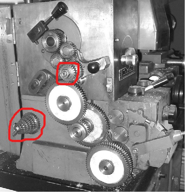

As in attached picture - the stud with the stack of unused gears is circled lower left, and the stud gear in use is circled in the centre.
- Stud Gears
- stud gear.jpg (101.99 KiB) Viewed 13360 times

Re: Feed speed chart
Hi Andy removed the stud gear on my lathe as per marked photo.
No letter on it just the number 24 which from your description makes it the "D" gear.
Does this mean I can only use the combination of feeds that has the D listed on the plate.
Regards Art
Regards Art
Correct - but that still gives you as good a range of feeds as you'll need for most jobs (as amateurs we don't need to optimise speed / feed rates) and a lot of the common metric thread pitches.Artysmarty wrote: ↑Tue 15 Oct , 2019 13:16 pmDoes this mean I can only use the combination of feeds that has the D listed on the plate.
