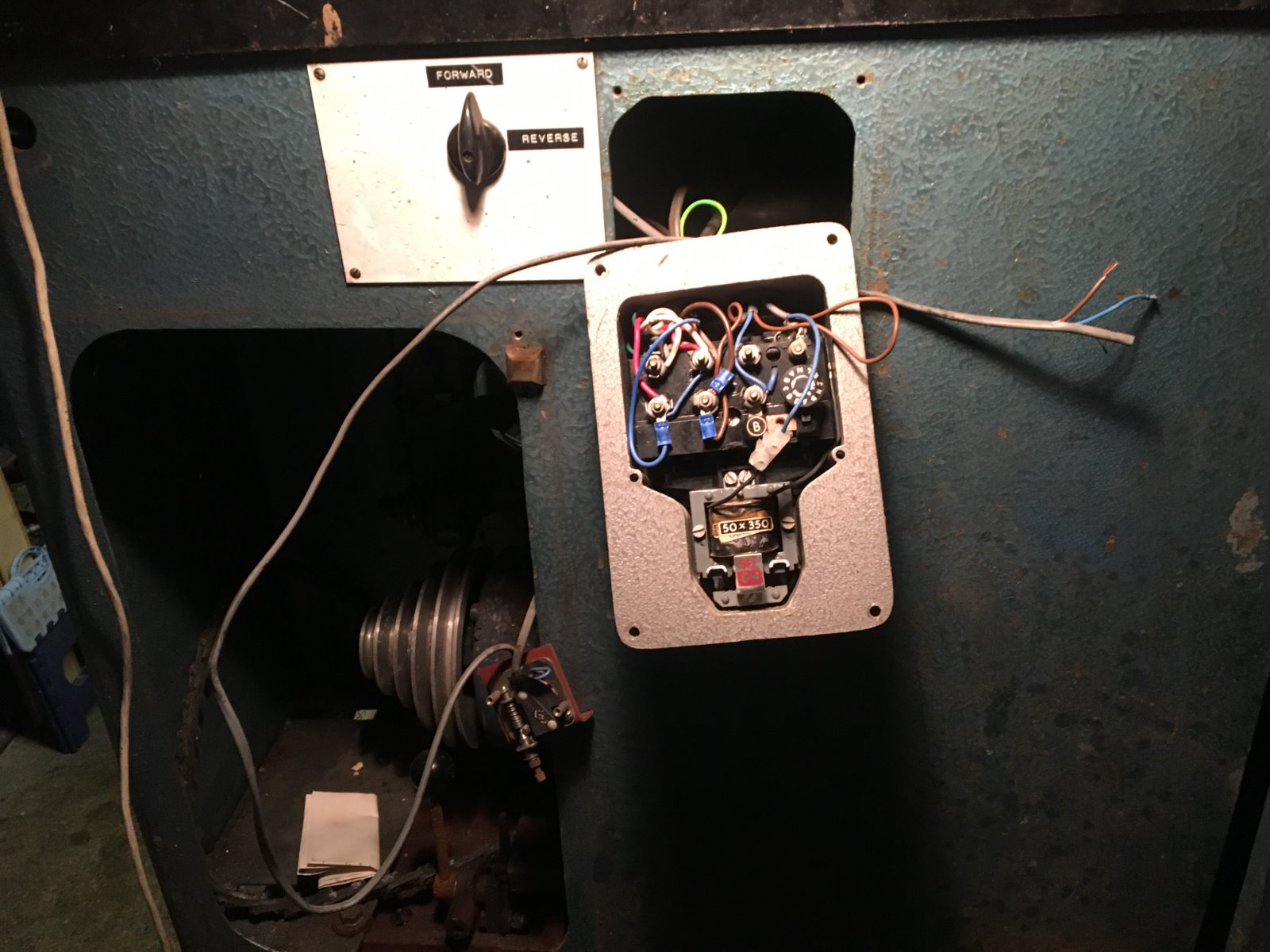

I have just acquired a Viceroy lathe model TDS R.C.S The motor will not run as the wire from the door switch has been cut and I can't see where the wire runs to from the switch. The wire comes from a Brook Motors on/off switch but I cannot see where the wires terminates from the switch. I do not know the age of the lathe but it also has a forward and reverse switch. Your help in resolving my problem will be most appreciated. I need to add that its a 240v machine

I have checked every page but there is no wiring diagram. I need a wiring diagram or a termination point
for the wire from the door switch but I can't find one anywhere. I am struggling to find where to go next.

Thanks for the wiring diagram the motor now runs I just have to put the machine together to do some machining
thanks again.
