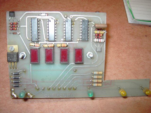

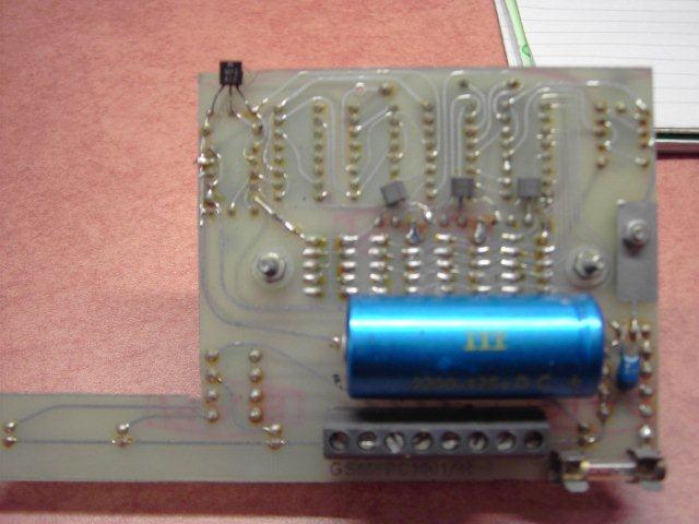

Hope these photos help

Thanks for the pix - looks identical to the 'type 1' photo in the other thread.
So connections are definitely as given above.
