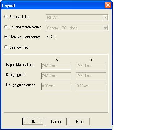

When I try printing to my Versa Laser VL300 I get the wrong area size and it is "Greyed Out" not allowing me to make any changes
VL300 printer.JPG (25.62 KiB) Viewed 5510 times

1. Ensure your VL300 is the default printer (Start\Printer and Faxes)
2. Reinstall the Versa Laser software
Post by bradders » Fri 11 May , 2007 9:36 am
From
START
PRINTERS AND FAXES
Ensure the VL300 is the default printer
Right mouse click on it
Select PROPERTIES
Check here to see what the printer size is and modify to suite if they are the wrong sizes
