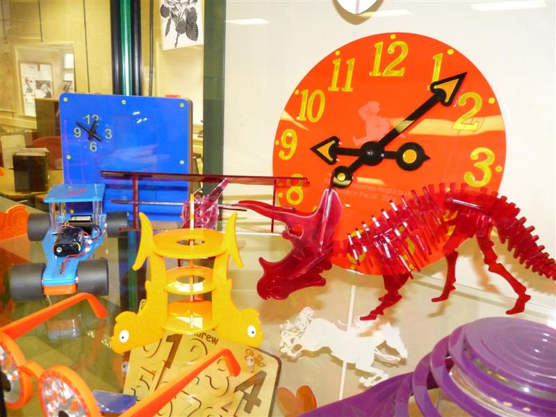

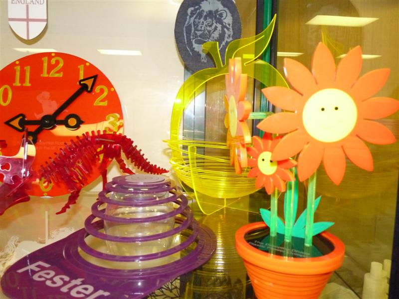

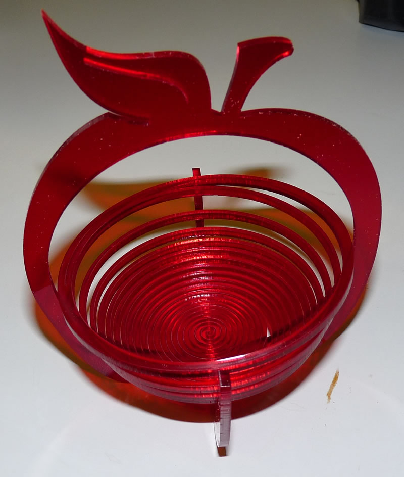

Here are some acrylic examples we have cut from 3mm to 6mm sheets
