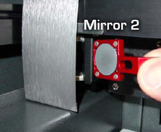

The mirror has come lose and disolodges as the laser travels around the bed. How should the mirror be fixed securely?

From what I have managed to find out, the mirrors are held magnetically, so I guess either the magnet has come un-glued, or the magnet has been de-magnetised (maybe its been dropped ?)

Are there 4 magnets in the corner of the back of the mirror? If so they have lost their magnetism. In which case, given the very small ammount of use this laser has had, can we have a replacement please?

Ok - I have found some more info on the mirror (s)
I presume your problem is with mirror 2 ?
I'm going to post a new topic on how to replace these mirrors
Versalaser mirror 2
Versalaser mirror 3

Yes its mirror 2. there appears to be no magnetic attraction what so ever, so cutter remains out of action!

Ok - we can get you a replacement mirror FOC - we are going to log your fault and machine s/no with ULS in the States, and get a replacement shipped as soon as possible.
