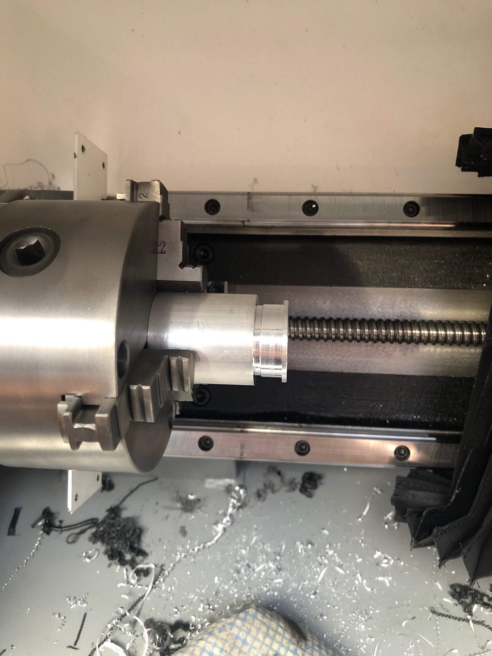

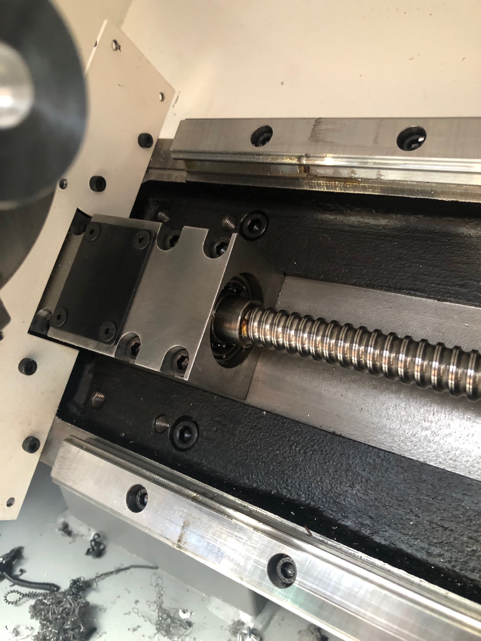

Post by Jimsiss » Mon 04 Sep , 2023 22:20 pm
I’ll have to get a look under that plate when I get a chance. As you can see it all looks clear at least.

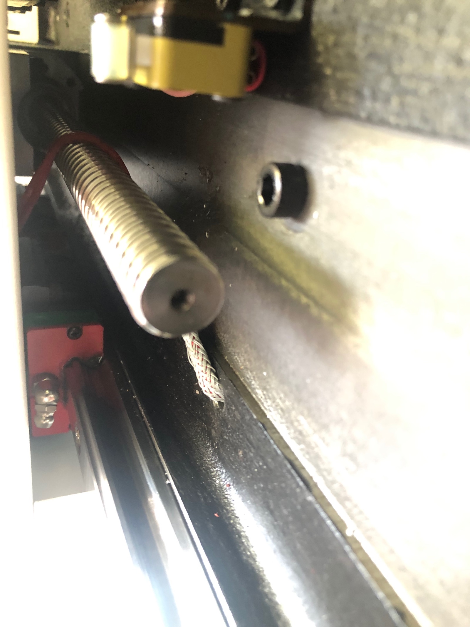

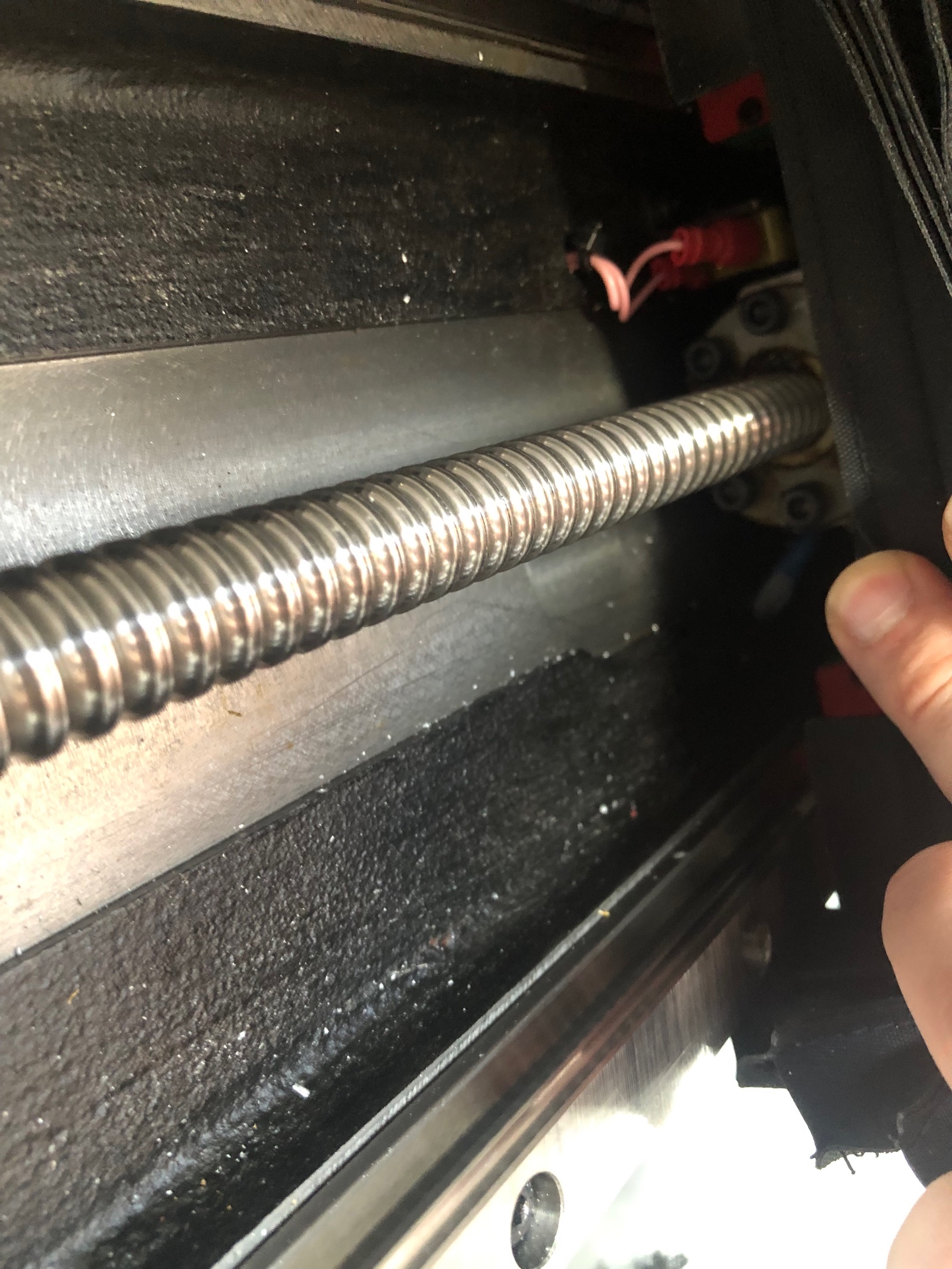

Just tried jogging it again and nothing happened this time.
I took the right hand bellow off and the wire was wrapped around the lead screw. I’ve untangled it now but I’m concerned it’ll get around it again. Is there a way to keep it from happening again?
Posts: 1927
Re: New problem
Post by Martin » Mon 11 Sep , 2023 9:35 am
You should be able to bend the wire & lay it in a position which is away from the lead screw.
