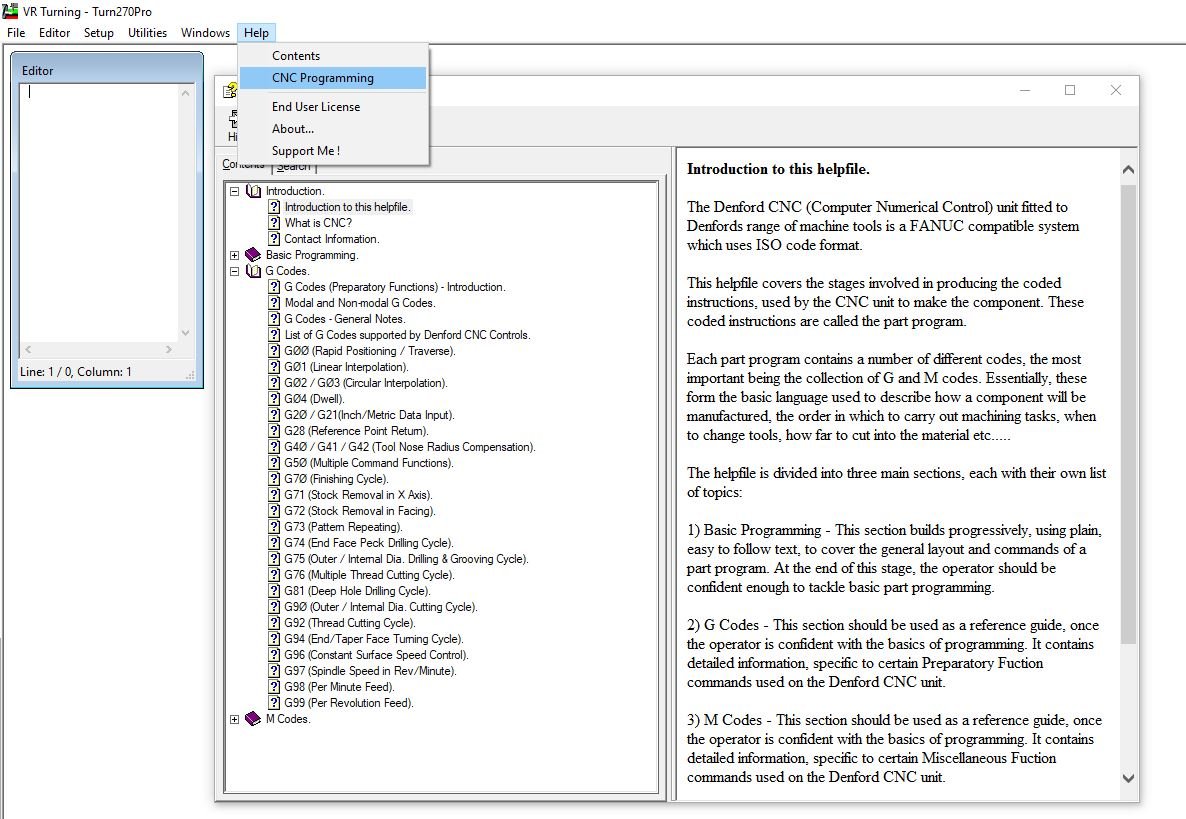

I am trying to use som incremental progamming on my Turn 270 Pro.
When i use it it says: 91 : Error in code, Value is invalid.
I am using VR Turning software.
Is there any workaround?

Unfortunatly G91 is not supported in VR Turning.
The supported codes are listed in the help.
g codes.JPG (190.48 KiB) Viewed 11711 times
