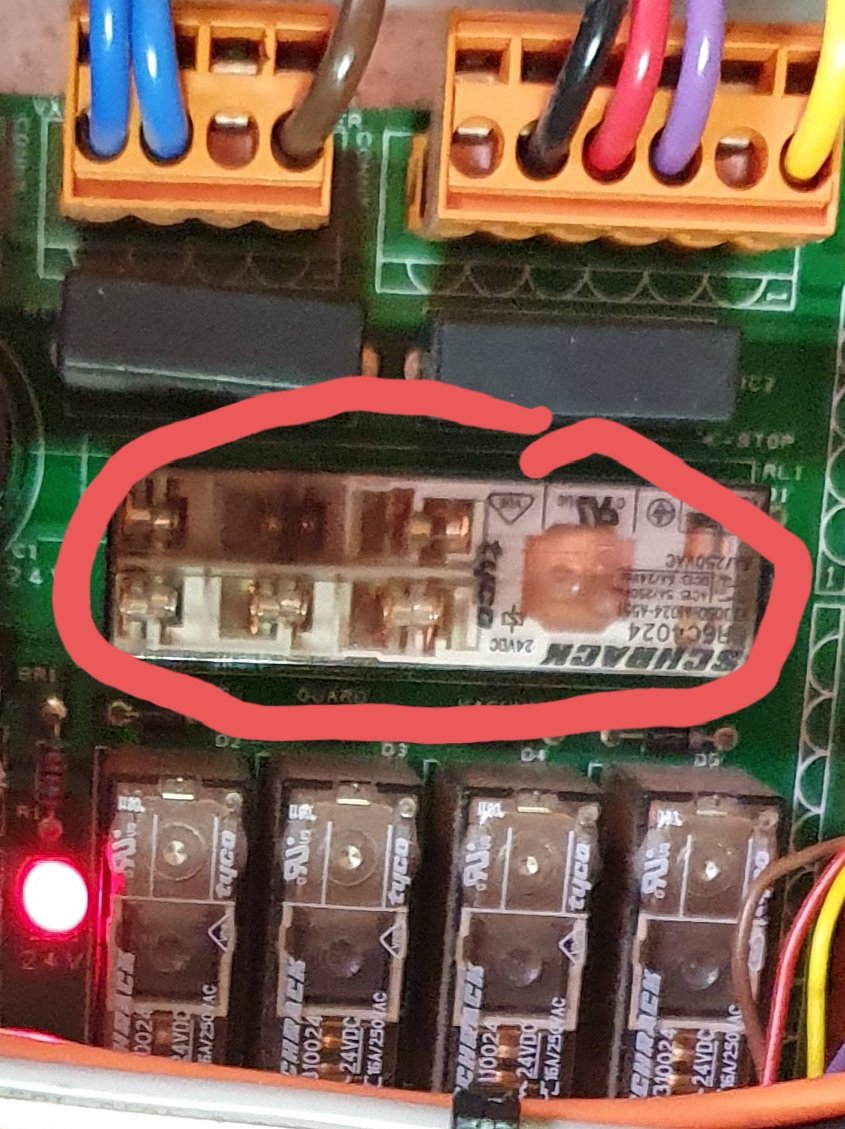

OK I have an issue when I fire up the machine it won't let the autolock release the door. I have checked the 7 visible fuses and all are OK.
I notice a slight darkening on one of the relay switches could this prevent the door opening. Any help would be appreciated

Hi, sorry i didn't pick up on your earlier post so here is me with the 1st post of 2021, as it has just tipped midnight and here is how 2021 is probably going to roll (one day the same is as the next). You have the a later board than i have come into contact with, I have seen them but not looked at. I think Steve or Graham are the ones that would be able to help.

Let's hope this new one is an improvement on the last one. Thanks for the reply, I am hoping I can fix the issues by distanced support and learn how the machine works at the same time. As a last resort, I will ask Denford to send an engineer out (If they do this to a residential location?) of bite the bullet and pallet the machine up and send it to them to fix and service. Both the later will depend on costs as redundancy and Christmas has sapped my funds.

How are you on electronics and a multimeter? looks like the diagrams are here... https://www.denfordata.com/bb/viewtopic.php?f=49&t=3722

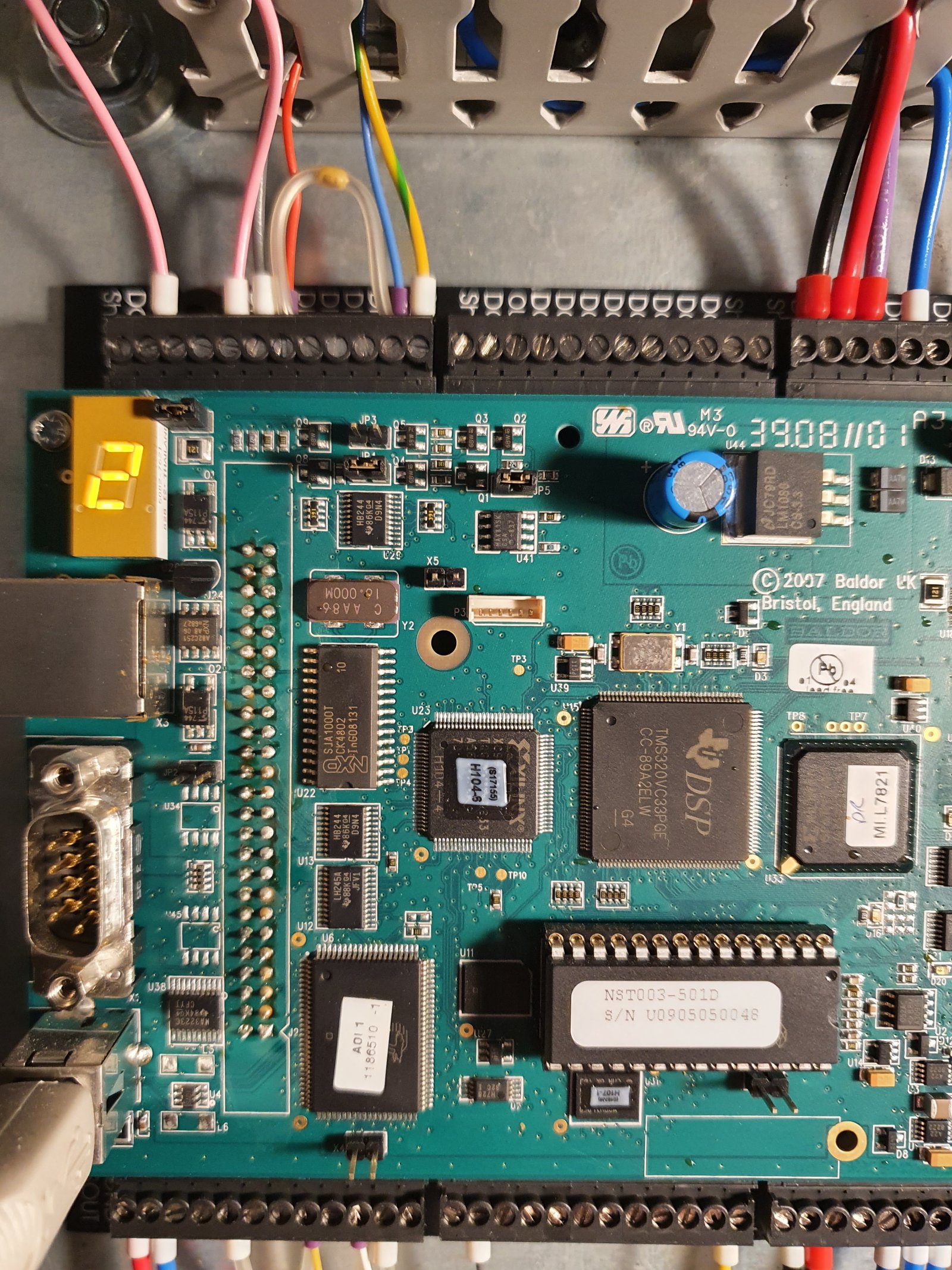

Will have a go this weekend have a guy how is going to go through the basics with me tonight so hopefully I can track down the issue or fault.
Just to get me going on the board at the top left hand side there is a yellow led number 2 is the normal ?

the numbers are actually letters. There is a list somewhere on the forum to 'decode' what it is saying, Took me ages to understand the 'numbers' it was flashing up at me once was E 5 t 0 P, or E Stop, meaning the emergence stop was pressed!
Not sure is this is valid on the later boards but I think it will be https://www.denfordata.com/bb/viewtopic.php?f=54&t=3167
Now looking back through your problem and that display code looks like the E stop is pressed, if it is seeing that you can't open the door. So it looks like there is an issue on the E stop or have you gone and knocked the button and not released it?

The NextStep card display is different
https://www.denfordata.com/bb/download/file.php?id=2228
The door will only unlock when power is supplied to the machine & the Emergency Stop push button is released.
Can you confrm if the Emergency Stop is released.
- RnD Tech
- Posts: 11
- Joined: Tue 03 Mar , 2020 21:59 pm
- Hardware/Software: Denford 270 Turn
Boxford VMCi 300
Fusion360 - Location: Cardiff
Re: All the gear no idea
Hi Martin Yes the EStop was released. After a few hours of checking different items, we found a lack of power going to the EStop.
The company I purchased the machine has collected to the machine today and have taken it back to sort out, As the machine was purchased without seeing it work that have done this all free and have offered a full refund should there be no way of fixing and displaying the machine in full working order.
So for the next few weeks its time to get the Boxford VMCi 300 up and running
Thanks for the help Pete and Martin and be assured there will be more questions soon.

Well after 16 months I now have both the Denford 270 (This went back to the factory and fixed) and the Boxford VMCi300 are connected to a laptop
Sadly not the one I was hoping too hook up to but I am happy to be able to move forward.
