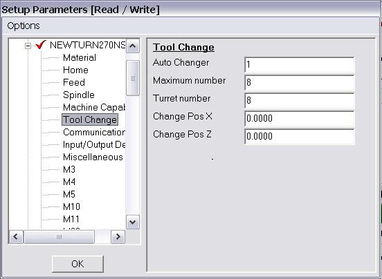

The software needs to know that the Turn 270 has a tool post fitted.
On VR Turnings top menu bar select
SETUP > MACHINE PARAMETERS (Password denny) >TOOL CHANGE
- Tool Changer.JPG (34.12 KiB) Viewed 33666 times

Hi Bradders,
Just had my 270 upgraded to 270Pro and am experiemncing similar problem as before eg tool changer not responding when requested.
This time i have checked as you previously suggested, that the tool changer is set to 1,8,8. Perhaps if you could kindly suggest anything else, i'd be greatful.
Many thanks, Graeme

Re: 270 lathe tool change command results in ...silence
Have you got the correct machine selected?
It should be a Turn270Pro.

Hi Bradders,
I opened the machine settings option using `denny` and it showed the 270pro option auto expanded then 'tool change' showed 1,8,8. Although i uninstalled previous version of vr turn before reinstslling i dont recall specifically selecting the pro.
Cheers, graeme
Did the machine come back to Denford for upgrading to Pro ? What was changed, just the chuck and spindle drive+motor ?
I'm wondering if the machine type has not been programmed onto the control card, causing the mint logic to behave differently.
Have you got the serial number?
Is it HO5223. If it is then it needs the new software & to be set as a Turn 270 Pro which should have the toolchange set as type 6
Without connecting to the machine, go to setup then select Turn270 PRO. You now have a different turret fitted so need to select the correct machine

Thanks Martin, Steve and Admin,
Well, the correct machine was selected but by changing the Tool Post, Auto changer option from 1 to 6, as suggested, the turret responded to manual and programme commands.
