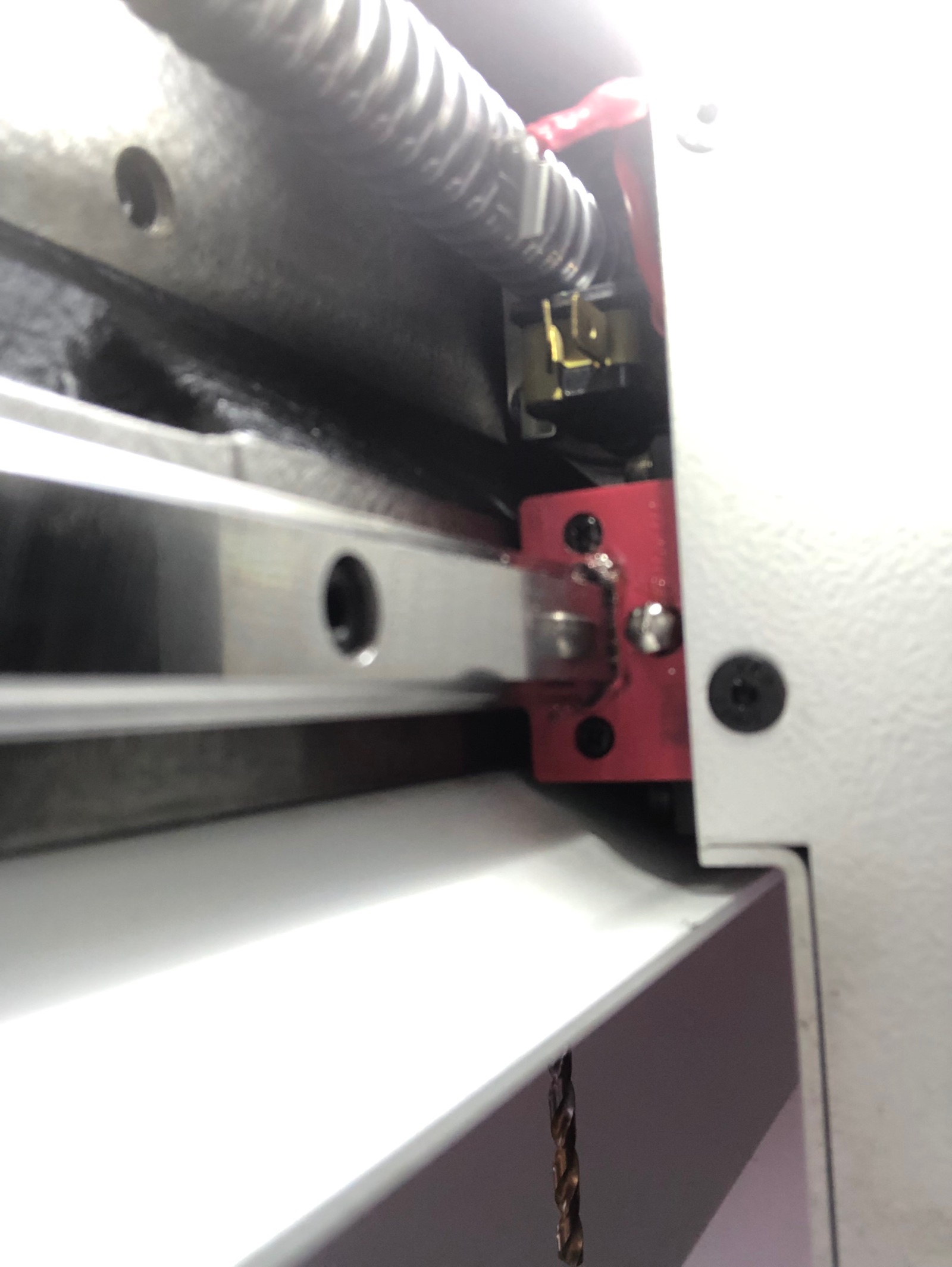

Might have found the issue, looks to have lost the connection on the limit switch. Can’t easily see to put it back on though

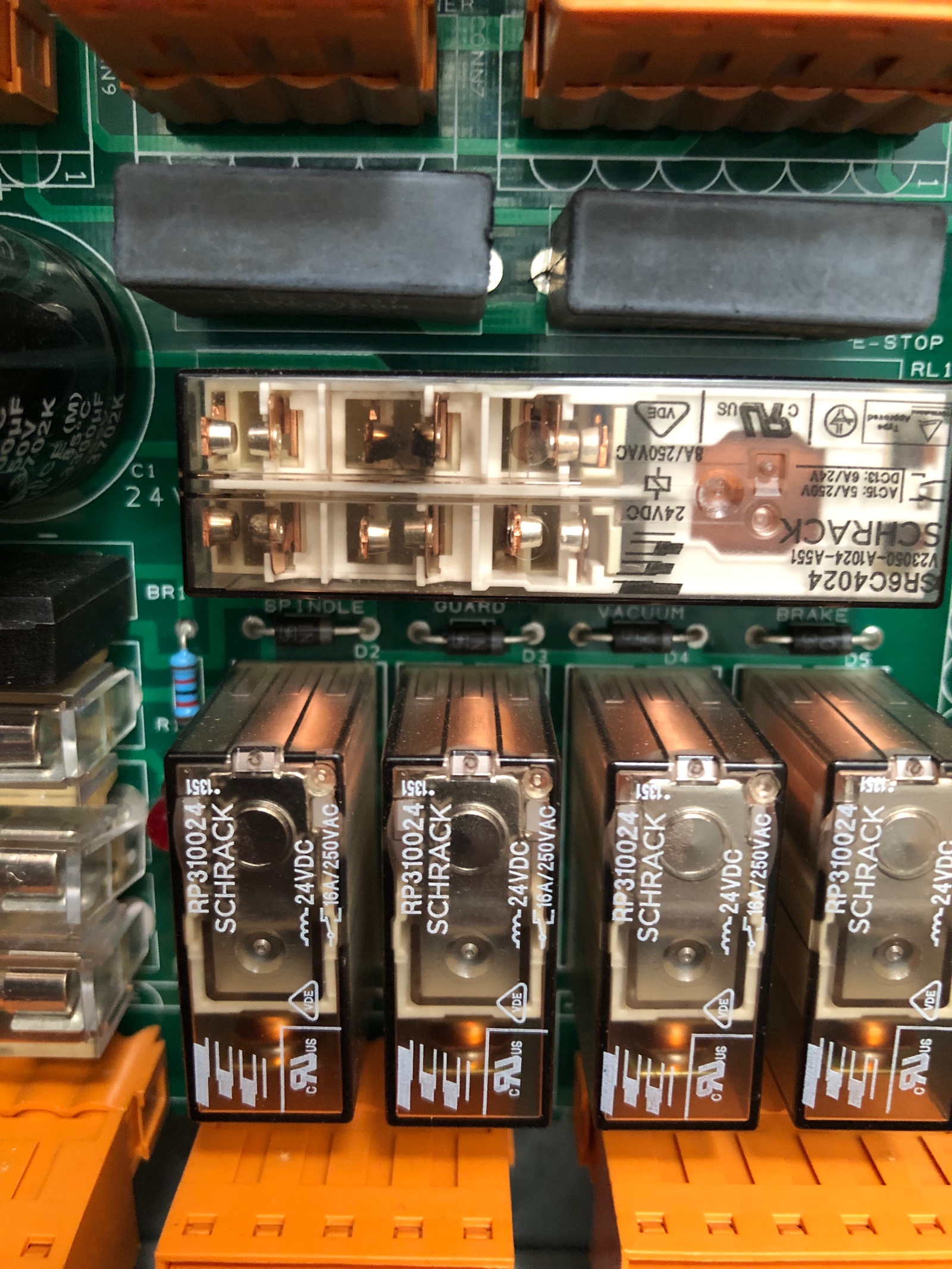

Done. It took about 2 hours total but it’s sorted. Spindle speed was working after checking the fuse so that’s not an issue. E-stop relay has one burnt contact though so that might need sorting in the near future.
Fault was the wire came off the limit switch, it was a terrible loose crimp so I tightened it with pliers (whilst under the x axis 🙄). The wire was very short so that took the longest to get back onto the terminal, not easy working in a mirror under the slide way.
