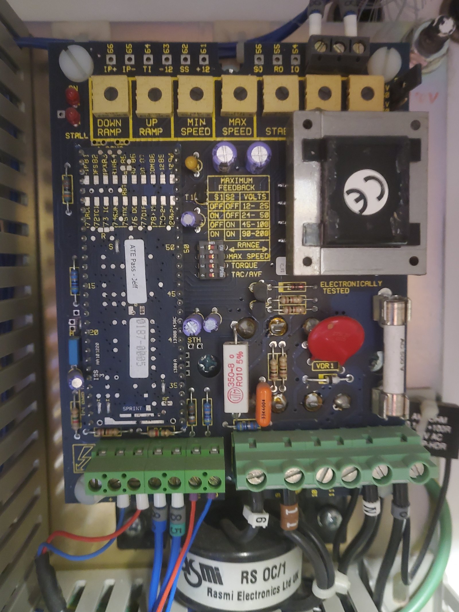

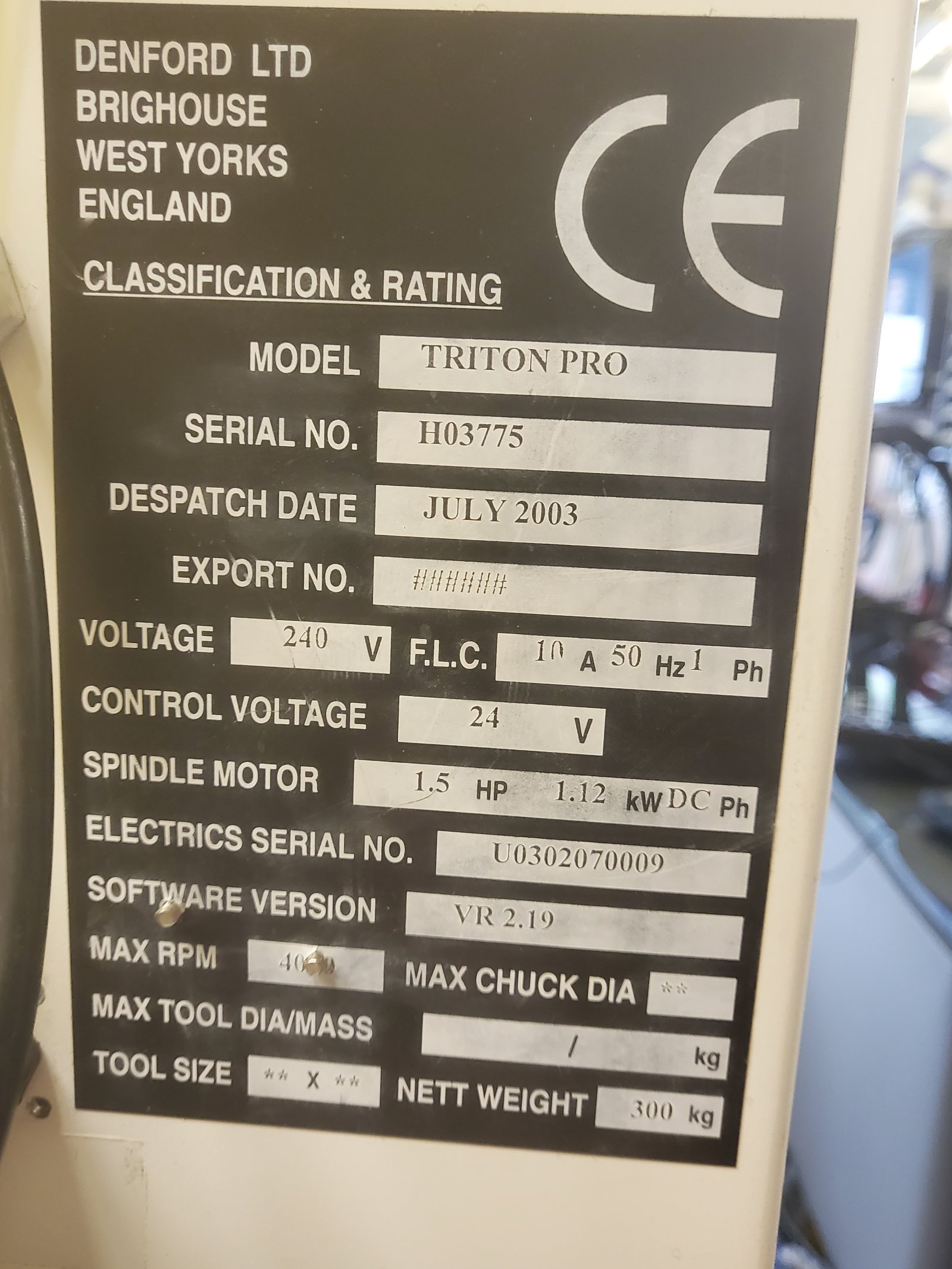

Can you confirm the serial number of the machine & what spindle drive is fitted.
Midy
Posts: 8
Joined: Fri 09 Jul , 2021 13:27 pm
Re: Triton pro questions - need help
Post by Midy » Mon 12 Jul , 2021 18:10 pm

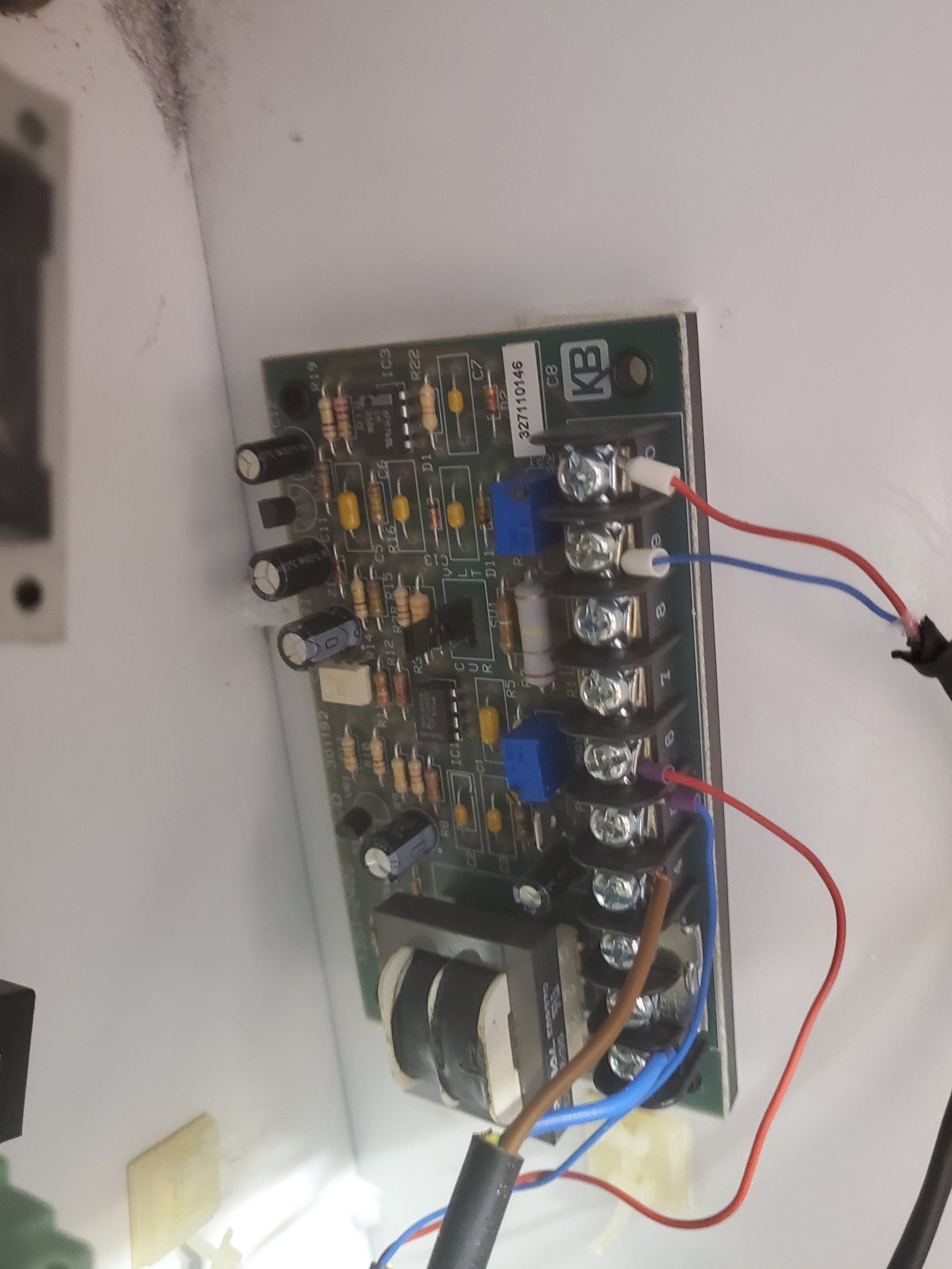

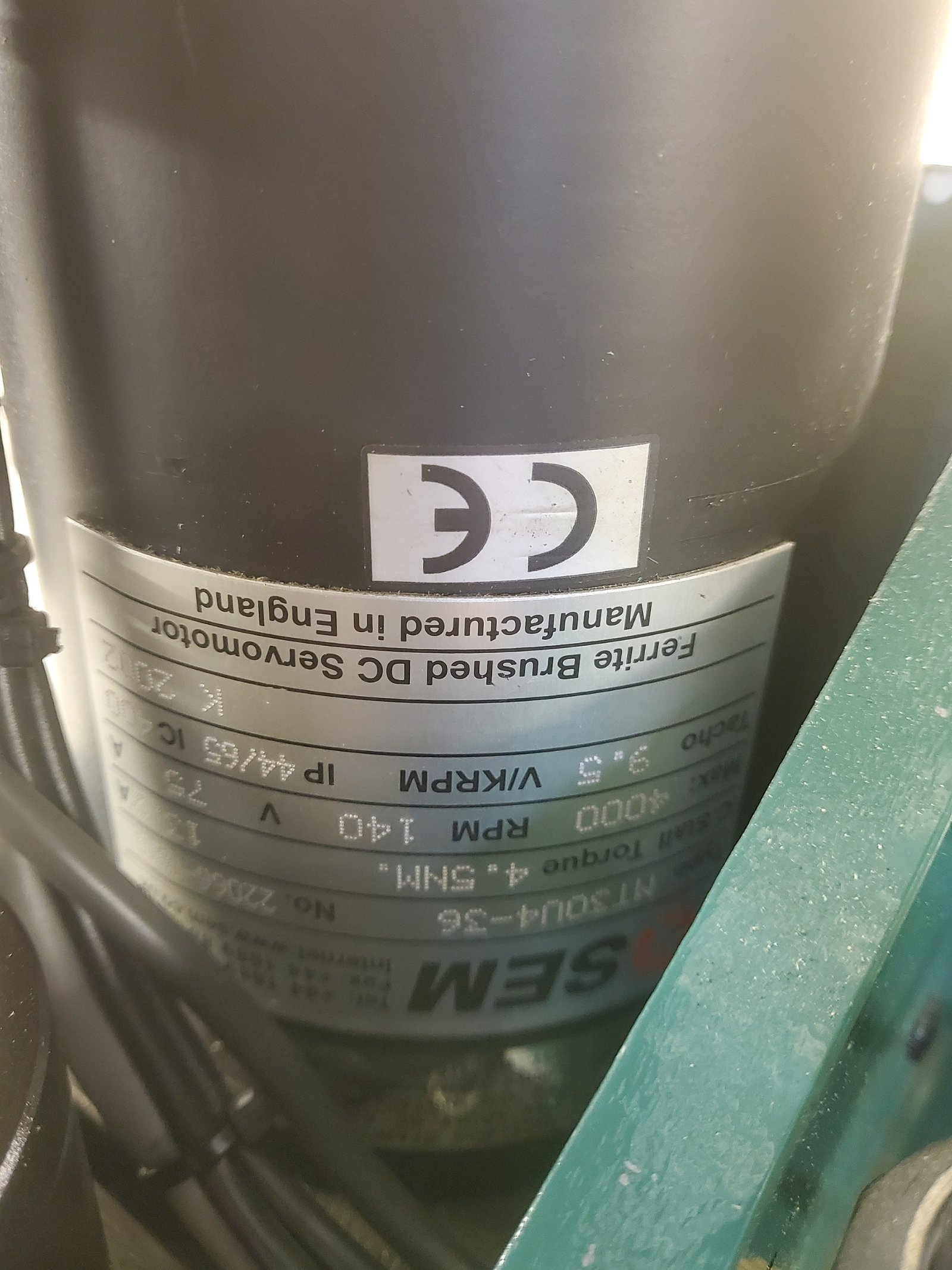

Hi, thanks for the reply. Attached photo's as thought it was more precise?
There is a KBSI240D inbetween drive and motor, recommended by centroid (control is acorn)

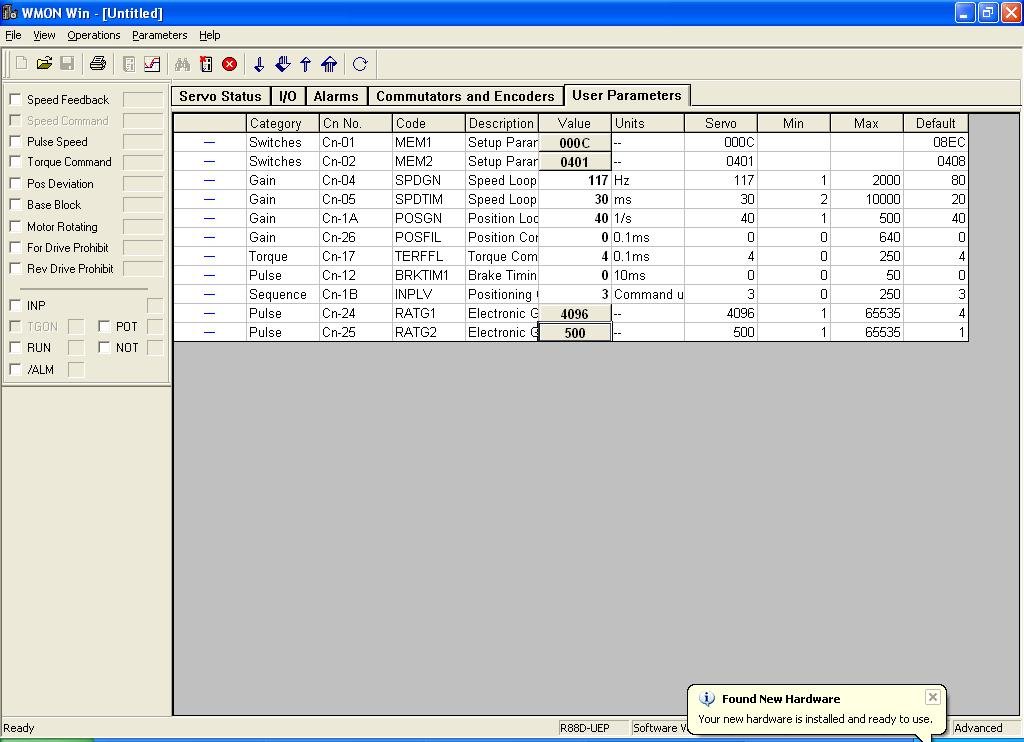

I'm also struggling with setting the servo steps per rev (only ever had steppers) I have the WMON software and a cable and can access the servo's but just can't figure it out.
servo params.JPG (108.77 KiB) Viewed 19889 times
spin motor.jpg (393.54 KiB) Viewed 19889 times
spin drive.jpg (467.39 KiB) Viewed 19889 times
data badge.jpg (370.09 KiB) Viewed 19889 times
kbsi 240d.jpg (282.01 KiB) Viewed 19889 times

Post by Midy » Wed 14 Jul , 2021 16:45 pm
I've managed to figure out altering the servo params, so i'm just needing a bit of help/info on been able to reverse the spindle please?
Post by Martin » Thu 15 Jul , 2021 7:19 am
The DC Sprint drive will does not have a reverse input so you will need to add a spindle reverse relay & invert wires 9 & 11. Make sure the spindle is not running when you change direction though.

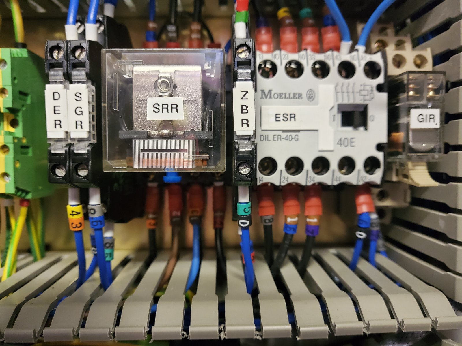

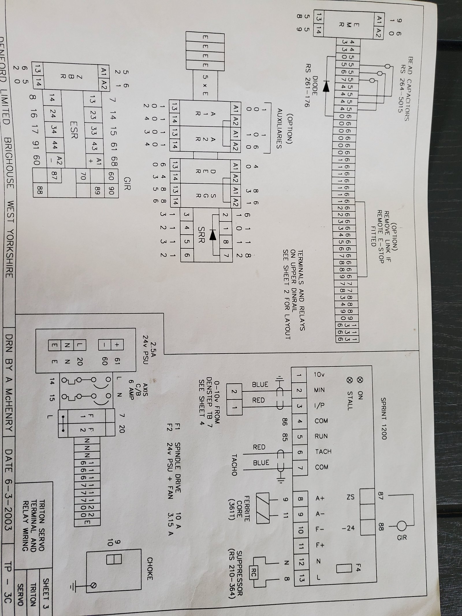

Thanks Martin, could you point me to a suitable relay on ebay or similar please. Also i've included a couple more photos of a schematic that was with the machine and photo of some of the relays etc. What does SRR stand for?

DavidB
Posts: 180
Post by DavidB » Sat 17 Jul , 2021 1:29 am
SRR is normally Spindle Reverse Relay so it looks like you already have one wired in just need to wire it to your new controller.
Midy
Posts: 8
Post by Midy » Sat 17 Jul , 2021 12:37 pm
Thanks for the reply David. I was thinking the same thing. Would you agree that The signal for reverse from the control should go to connection 7 on the SRR?
