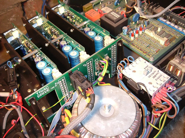

So, i've managed to establish that the reason that the toolchanger wasn't working, so far that is, is due to it's supply coming from the Main Contactor located at the side of the Drive boards which wasn't being energised.
When I first got the machine fuse F1 was blown so I have replaced that and also checked all other fuses are ok.
To eliminate a faulty Main Contactor I powered up the machine and then 'made' the contator by pressing (with insulated screw driver) the grey button on the top of it.
When I did this the green LED, just visible in the pic between fuses F1 & F2, briefly lit before both fuses were blown. On the up side power was supplied to the ATC control, main PCB, and spindle DC motor control board. I appreciate at this point I ain't going to get drive to the axis but I pressed the ABS Datum button on the machine front panel. The machine then displayed that it was moving to Z datum, which obviously it wasn't as the drives had fused. I removed my screw driver from the Main Contactor and powered down the machine.
So, looking at the Drive Cards nothing looks too obviously wrong but it took out the fuses so something must be up.
Appreciate any advice ...again!
Thanks ...Richard

I'd suggets removing the 3 x Digiplan axis drive cards, replacing the fuses then powering up again.
If the fuses stay good then start adding the cards one by one (powering down in between!!!) to see which axis has the fault.
If you find a faulty axis it could be the card that's faulty, or a short on the motor output cables (I've seen a z axis stepper motor cable get trapped inside the column and short out before now).
You can temporarely interchange cards to check if it's a faulty card, but make sure they finally end up back in the right place (becuase the Z axis has a 3 amp card and so a 2 amp card in this slot will give you Z axis stalling problems further down the line)

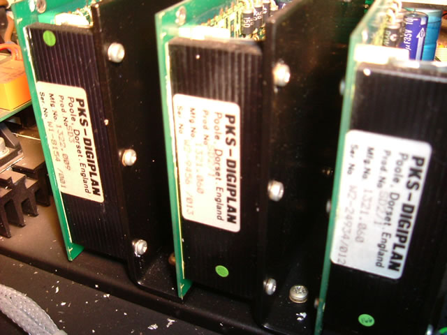

Swapped over the X and Y cards and that reversed the problem. Checked the surface mounted fuses on the suspect card and they were ok.
Tricked the machine into thinking the faulty axis had datumed and everythin came on line ...even the ATC!
So, does anyone have a spare or redundant PKS-Digiplan SD2/1 card which they could donate, gift, or even at a push, sell me?
Tried the advert from November last year on the classified ads section but all that stuff had gone.
Yours in hope ...Richard

After scouring my contacts in machine automation (HNC, PAL etc) and pestering people that probably had better things to do, trying to source a new SD2/1 card for the Triac I ended up phoning Parker.
They told me that they did a repair service for the SD2/1 at £96+vat. The bloke then went on to explain that the cards were in fact very simple devices and that normally the only things to fail are one of the two chips and these were readily available off the internet for around £5 each.
Being from Yorkshire I baulked at spending £96+vat but £5 didn't sound that bad. As the main chip was plugged into the board I decided to swap it over with the chip on the good board to confirm that it was faulty.
I then refitted the boards and powered up the machine only to find I had movement on ALL axis :D :D :D :D :D :D :D :D :D
The problem must have been a 'dry' or corroded connection on one of the chips pins and swapping them over must have solved it.
