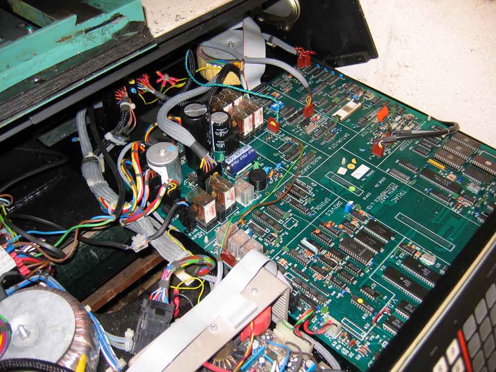

Post by jim the fish » Fri 26 Jan , 2007 15:39 pm
yes its the screen drive card. it looks like it has a carrying handle over it.
Jim the Fish
