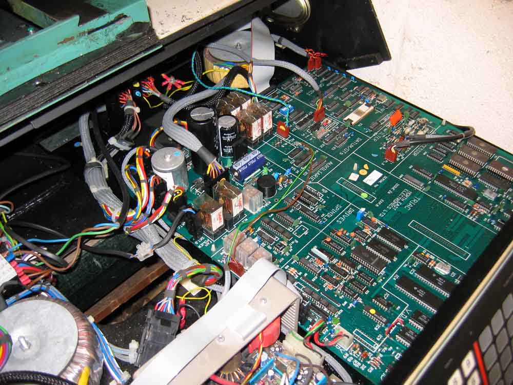

Have just aquired a D T ATC The small screen on front panel does
not work Had a look and the wires from screen not connected to anything
Insde panel just to the right of screen 4 plastics inserts are sticking up
something missing I think but what ?

Sounds like the CRT circuit board missing :!:
I'd try the monitor manufacturers (or maybe Denford have some old spares kicking around)
Most of the time the large monitor that comes with the Triac displays exactly the same thing as the smaller one. It's only when you want to do Tool Path Graphics simulation that the small monitor shows the TPG menu, whilst the large one shows the Tool Path Graphics.

Yes its the screen drive card, picture attached its the part that looks as if it has a carrying handle. I have one with an intermitten fault, see to touch it and it works. If get it fixed will contact you.
