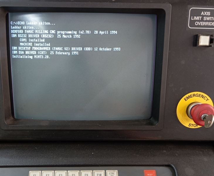

Problem: The computer does not connect "MINT"

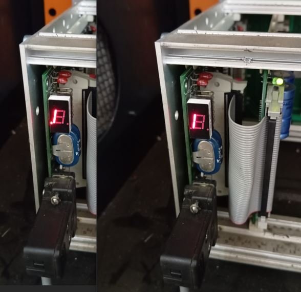

Description: When I turn on the machine, DOS is loaded and there is a wait for "Initialising MINT3.28" (see pictures). If I disconnect the COM cable and restart the machine, the message on the screen is the same. When the machine is turned on, the MINT control board on the 7-segnrmt display shows "8" followed by "L" with a pulsating dot (the display is broken, it does not display the middle and bottom segments, see photos)

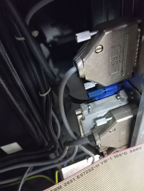

What I did: I cleaned all the contacts in the computer and the MINT board. I checked the COM cable, there is a transition on each PIN. I corrected the soldering of the COM plug on the MINT board.

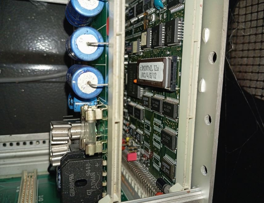

I think this may be a similar board to the Triac PC I have and there is a NiMH battery near the comms area which is prone to leak when old and the electrolyte may be effecting the signals in the area. Cleaning the area carefully with distilled or deionised water may help remove any deposits, allow to dry and see if that improves things. Don't force the drying just place somewhere warm like an airing cupboard till dry. I've also seen on the BB that the battery isn't used so could be removed. When handling the board do take appropriate static precautions.

It does look like the board is the issue. It looks to be displaying a "i" from the picture which is not correct.
