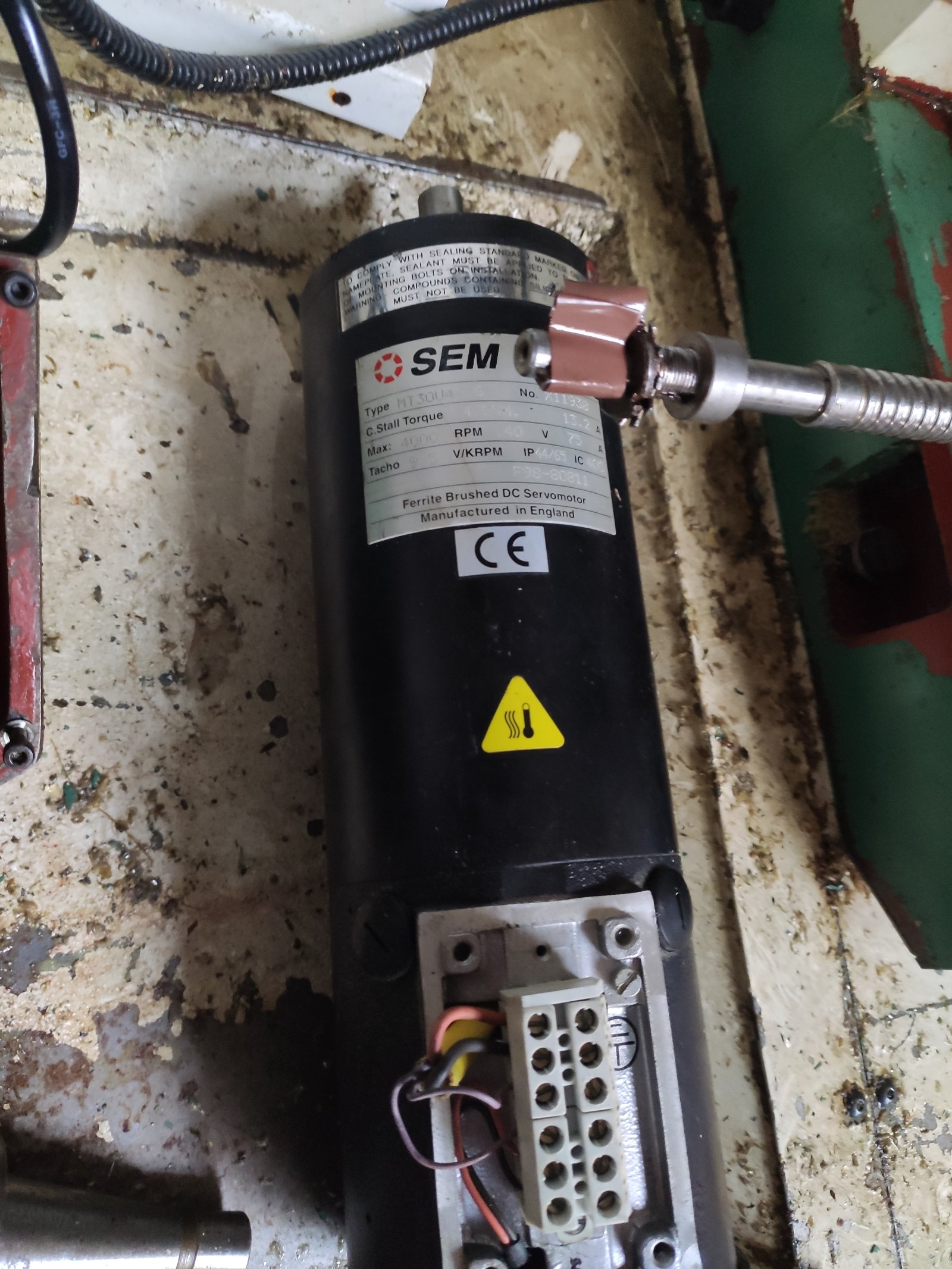

Hello from Ireland. I recently picked up this Denford Triac PC. The previous owner started dissembling and inspecting it. Looks like everything is there. Ball screws are free table looks in good condition etc.
My plan is to run it on Linuxcnc. I want to try and use the existing electronics and have been going through conversions done on this forum to Mach3.
Iv ordered a BOB from AliExpress and also ordered some transistors to build the little circuit to drive the original drivers.

Looking at the board it looks like it has a PWM and analog 0-10v spindle output. Will this drive the original spindle board?

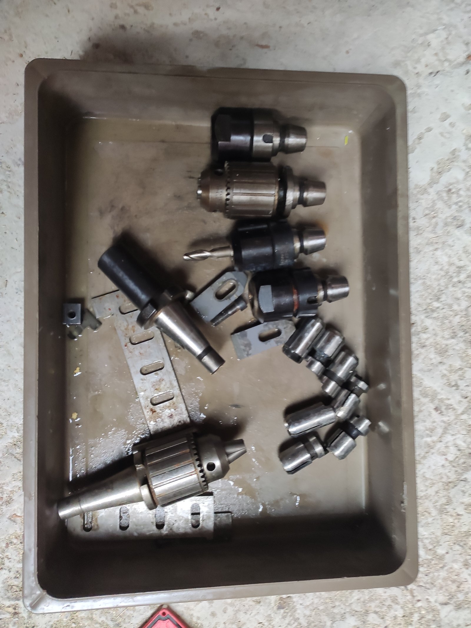

Also the tools in the pic are they the easychange tools??

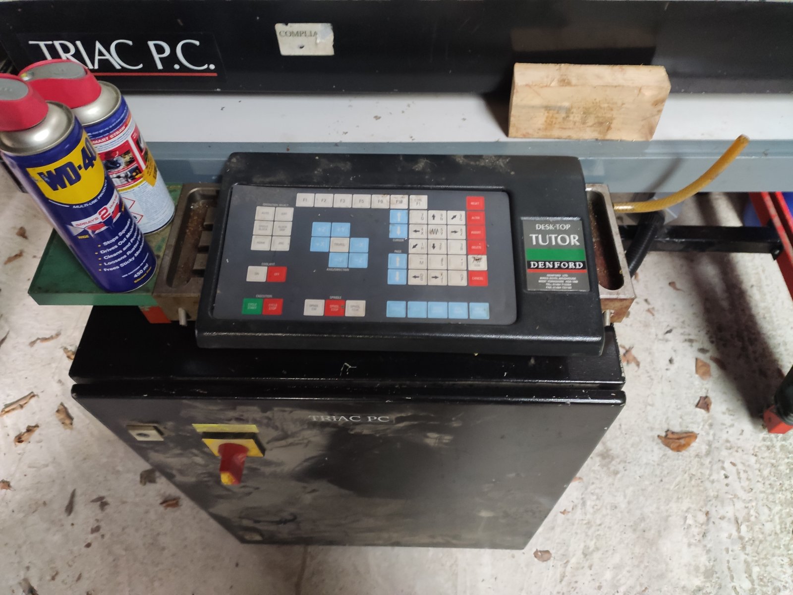

Denford tutor console came with it also I think they are a basic serial so would be easy enough to get working down the line.

I'm doing this as well at the moment and like you am intending to use the original drives, sensors and motors and use LinuxCNC. It's taken a while but today finished all the material prep for the stand so now have to weld all the bits together next week and get it painted and the Triac on top, fortunately the Triac came as a runner so it's all together so once in place the rest of the conversion should move along more quickly.
The tools you have are the Coventry Easychange tooling which is the same as I have.
Regarding the BOB I had a look and it locked my browser so I'm not going back but the main thing to be aware of is whether the 0-10V is isolated or not many cheap ones aren't, it really needs to be isolated as that input on the spindle card floats around mains voltage so if not isolated it can result in dangerous voltages elsewhere in the circuitry. I'm using a C11G BOB and that has an isolated PWM to 0-10V output for that very reason.
The tutor keyboard is serial, I've connected it to the PC in the past and had characters come up on a terminal screen when keys were pressed.

Yep not isolated, I used this little board to isolate it
https://amzn.eu/d/doKiPh3
I have nearly everything working now just needs tuning. Axis, spindle, oil pump, coolant pump, limits and homing sensors. All denford original boards using a cheap Chinese Bob.
