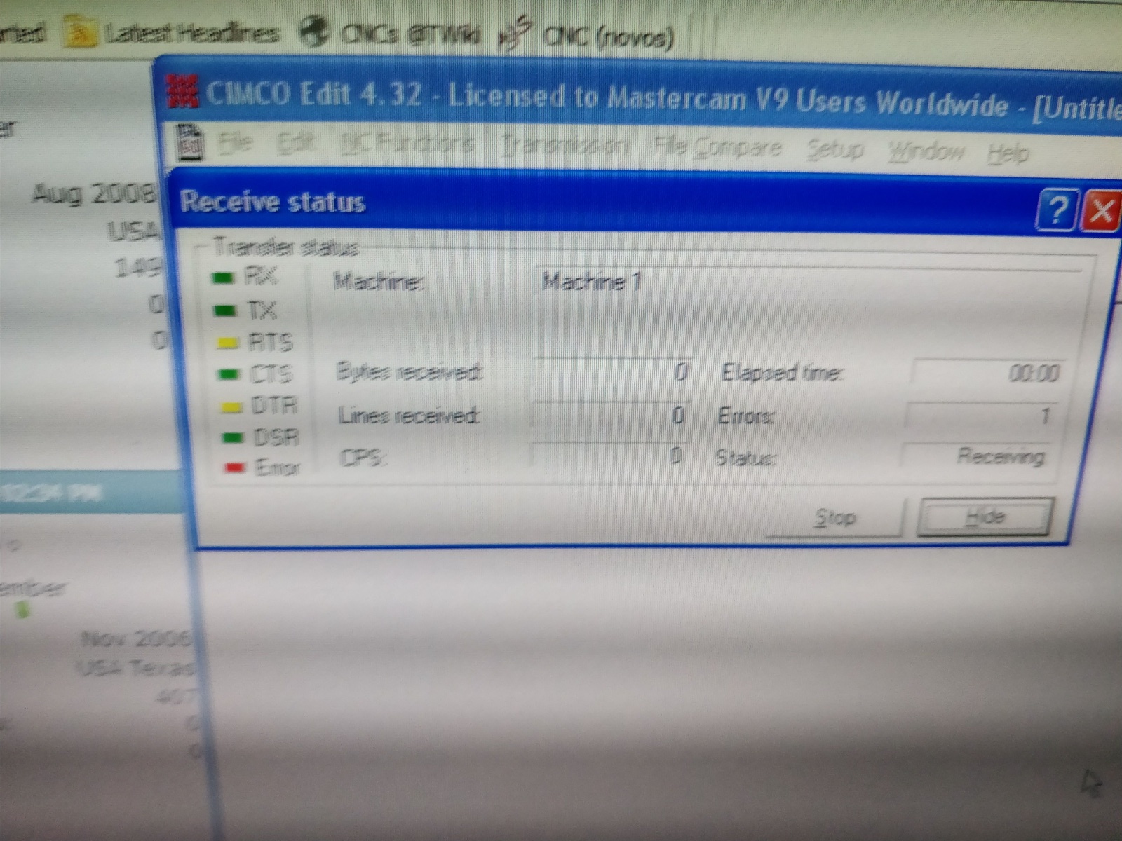

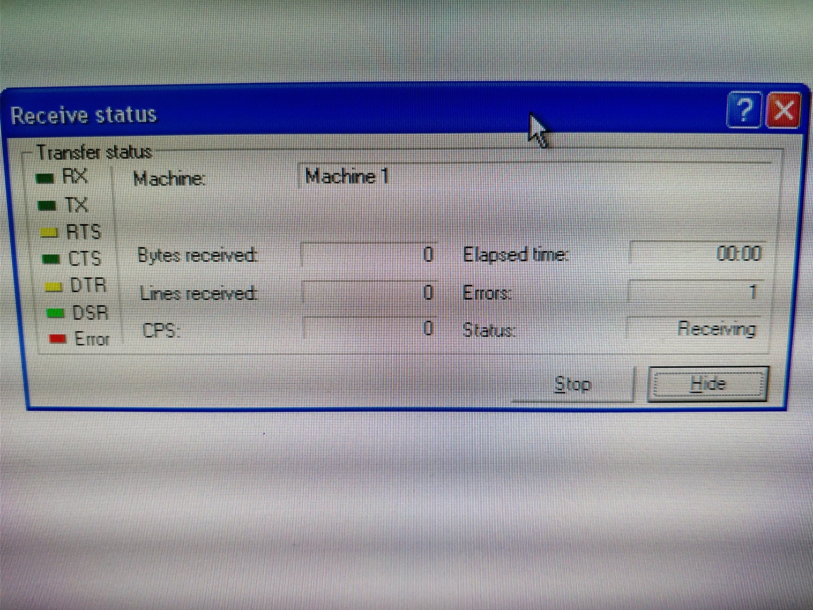

Hello,
@Martin, as you told me, I have compared all the "RS232 parameters" with the Cyclone ones.
However, even changing so the become more alike (the only one that I have changed was the 0002), the CNC still gives an error if I try to download or upload a program.
Also, the parameters that were in the "RS232 parameters" are aligned with old ones downloaded from the machine when it was working.
Now, from what I have been reading, the problem can be in the RS232 ICs, specifically the SN75188N and SN75189AN, that could be burnt.
Do you think this is what could be causing this error?
Attached, I send two images from the CIMCO error as well.
Thanks again for all the help.

Re: FANUC TRIAC SERIAL COM Error
Not sure on this now.
Are you using the same lead to connect to both machines?
If you send a program to the mill does the Fanuc show any errors?
First of all, let me apologize for the delay in replying, but I was on vacation and didn't see the post.
Answering @Martin, I have shifted the cables, so the only possible explanation will be on the CNC's serial COM side.
If I send any program, it does not show any error on the Fanuc, but it shows the error that I posted before.
