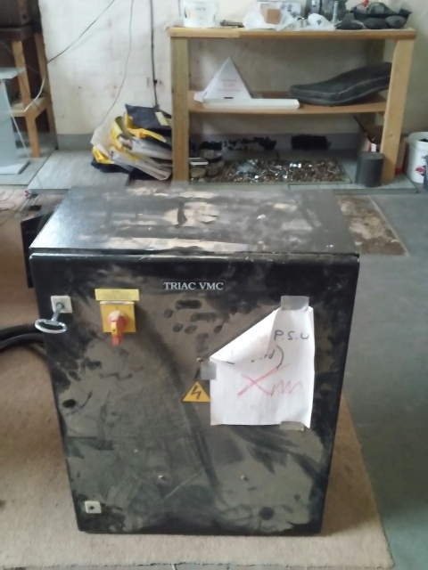

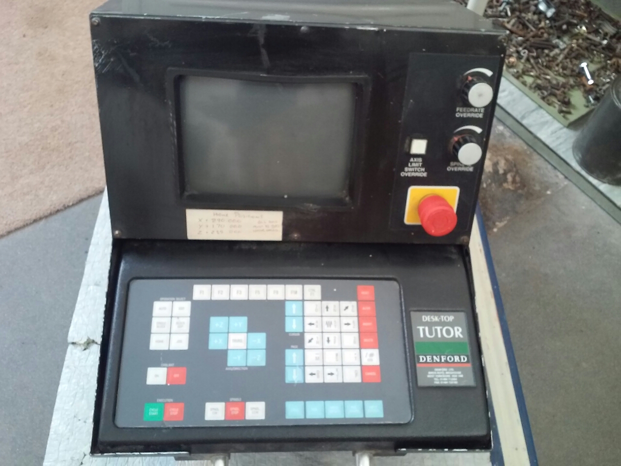

Thank you for taking the time reply. I now need to throw a bit of a spanner in the works. After asking the previous owner what actually happened to the controller (and sending a picture of the box), I now have the controller. It appears to be complete and in fare condition. The floppy drive front is damaged, but I have one from an old PC if required. There is no software, only a circuit diagram inside. I assume the original Denford supplied S/W was loaded at power-up from the 1.44Mbyte boot dos disk? To initially use this miller as a training machine for myself, what would be required to get milling? I assume there was some Denford specific files (Licence, S/W Key etc), CNC Interpreter/Application (Mint?) S/W, initialization files and the miller working program (if required). I guess I'm now asking how best to implement your Mach3/4 software upgrade suggestion, using as much as the original hardware with as little hacking as possible. What is the advantage of an isolated spindle drive over non-isolated? Does powering the spindle motor from an isolated LV transformer do similar? I hope the 2 photos included are smaller. I have reduced the file size.

If you want to try the absolut minimal approach, download the DOS software from the denford site, copy it to a floppy, and see if the machine powers up and loads the software.
Barebones conversion would be Mach or LinuxCNC via parallel port with a 24V capable breakout board (or two - one probably won't have enough inputs for the ATC).
Next option is to add a motion controller, where options vary from reasonably cheap to fairly expensive.
Regarding the spindle, they originally used an SCR style drive, which means the control wiring is at near mains voltage. You have to ensure you use a fully isolated 0-10V control source, otherwise something will release magic smoke.

Great, you have the big box so forget everything I wrote before

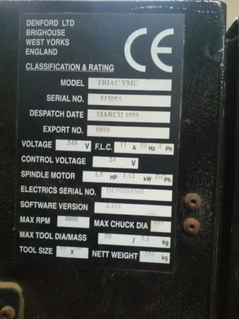

Contact Denford with the Serial numbers of your machine as there may be a little difference in the software for the 8 pot tool changer like you have and the 6 pot one. Probably just a parameter change but small things like that can easily stop a machine from running properly:D
Then like the previous poster said try firing it up, the blokes at Denford do watch this Forum so may jump in on this one for you as well
Good luck
Good luck
