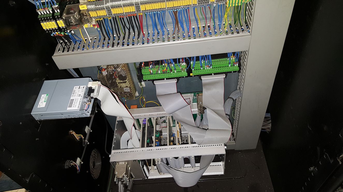

I have just obtained from a training school the above machine, which has been stood disconnected for a period of time. At first when I powered it up only the 2 fans ran in the control cabinet nothing at the monitor so it was recommended that I try a boot disk only to find the floppy drive had packed up. I purchased a new floppy drive which seems to be working but im still not getting anything at the monitor, I tried a different monitor and it was receiving NO SIGNAL. not sure what else I can do now it has the integral PC not a tower unit. Can anyone please help as I have no idea where to go now. It also appears to have 2 batteries on separate boards if these have gone flat would that stop the PC from working.
- JPEG002.JPG (143.82 KiB) Viewed 19428 times
- JPEG001.JPG (188.32 KiB) Viewed 19428 times
Re: Denford Triac VMC mill 2000 - 2001
The battery on the computer would just be for the bios so it would not stop the computer powering up.
Can you check the computer power supply is powered up.

thanks for the advise I will check that out later today, I have attached a couple of pics.

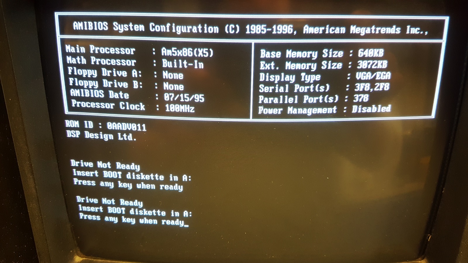

I have now soldered in a new battery to the DSP board and now the monitor has come to life
I inserted a MS DOS start up floppy in the drive but im still seeing the text in the photo, not sure where to go now. any ideas
cheers Ade
cheers Ade
- monitor 1.jpg (446.93 KiB) Viewed 19378 times
That's great.
You need to set the computer bios to enable the floppy disc drive.
You will need to connect a computer keyboard to the computer. If you then let it boot up & leave it for a minute you can then enter the Bios by pressing CTR+ALT+S at the same time.
Floppy Drive A should be set to 3 1/2" 1.44MB

Hi should it boot from drive C or A
I don't think you have a C drive looking at the pictures.
The Floppy drive is the A drive but its probally set to a 5 1/4" drive

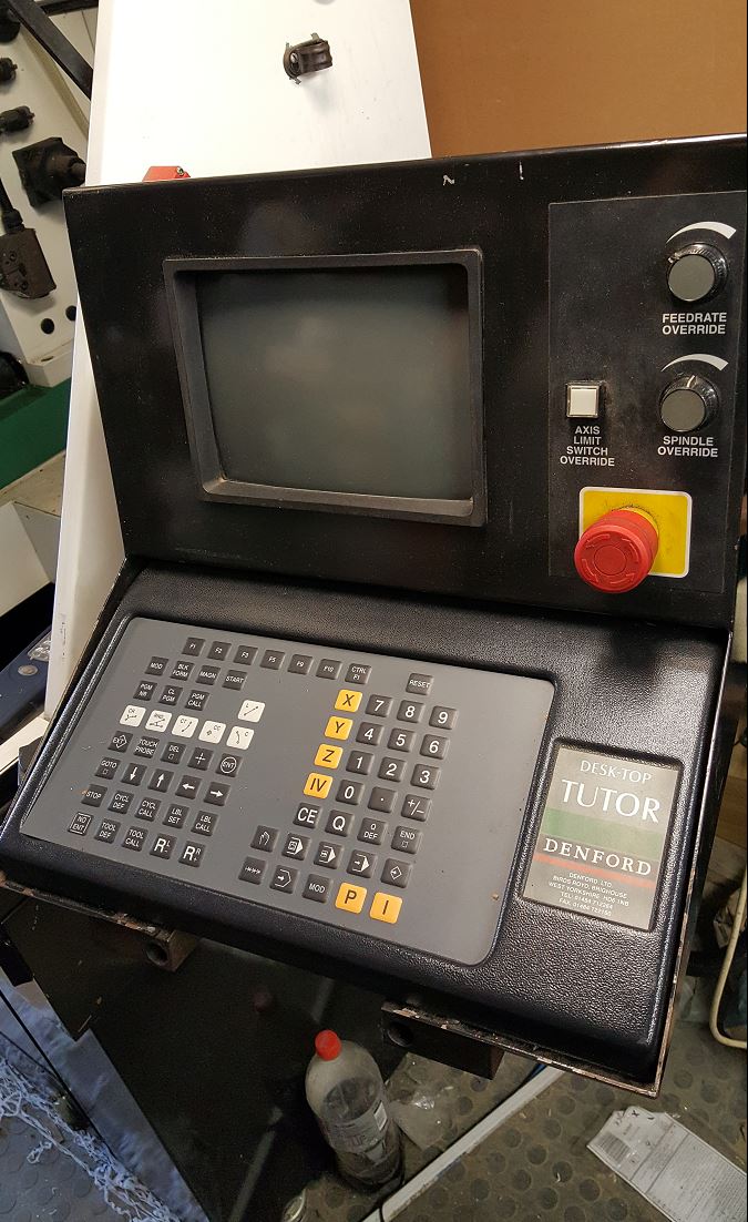

Hi Martin
Looking at the first picture in this thread, would you say it is Fanuc or Hedinhaine?
The overlays slide in and out & are interchangeable. The overlay in the picture is a Heidenhain. Have you got any others?

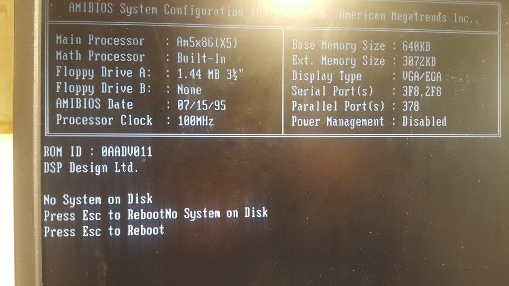

Hi yes I've managed to change that do I need to download .Opt and .goon 1 disc or is there something else i need to download.
You will nned to download Drivers.zip,Drivers2 & Heiden.zip & load it on a system boot disc.

Hi Martin
I had our IT department make me up a disc with all the drivers that you recommended, when I load this up the monitor is displaying 'No system on disk' do you have any ideas what I can do now.
