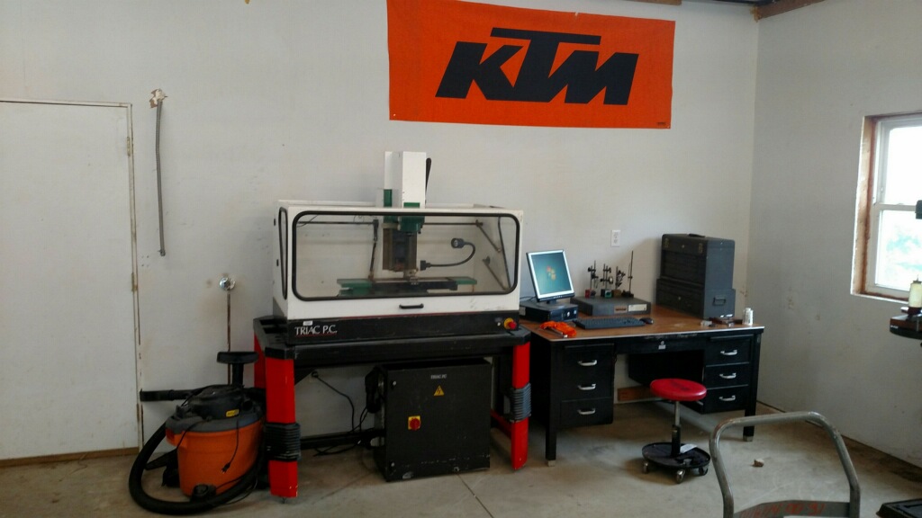

Re: Triac feed rate setting in VR milling 2
Post by alextaylor23 » Thu 25 May , 2017 22:02 pm
Might as well post a pic of the new machine
