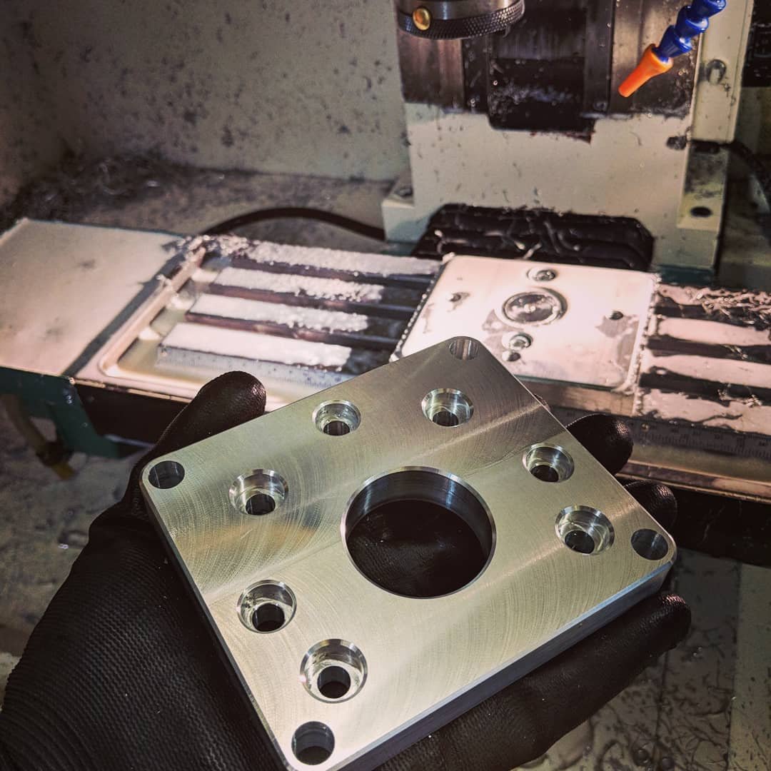

Post by dubstar_04 » Tue 17 Jul , 2018 18:06 pm

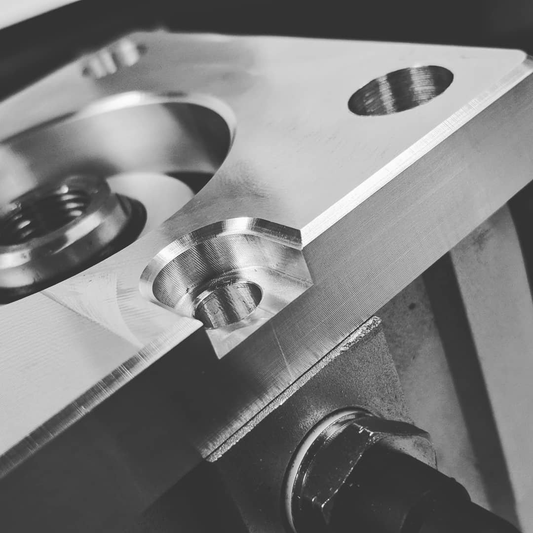

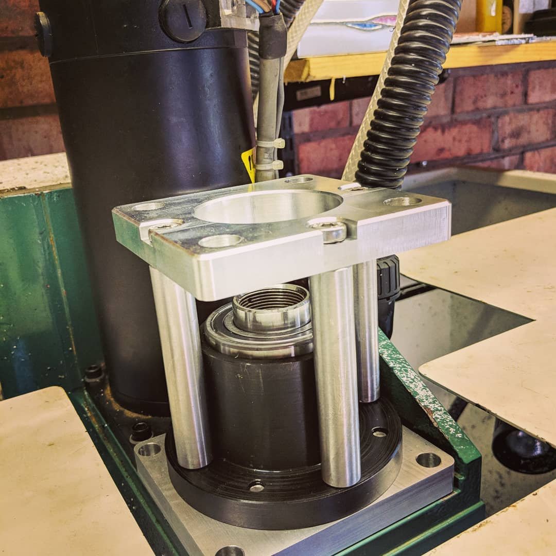

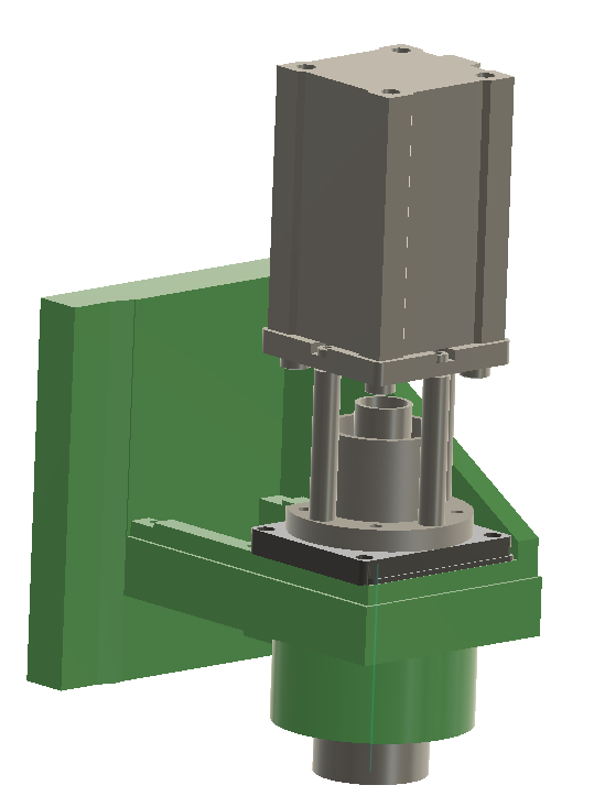

Post by dubstar_04 » Fri 17 May , 2019 16:43 pm
I have been using the power drawbar without issues.
I am sharing the fusion 360 model here in the hope someone finds it useful.
Please find the 3D model for the drawbar assembly attached.
Model Image:
Some photos of it being made:
Triac Tool Change.zip
(1.72 MiB) Downloaded 1026 times
