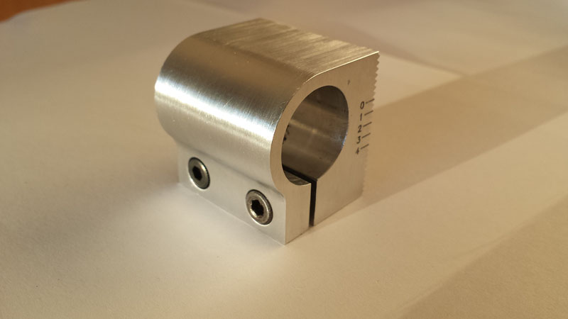

Below is a picture of the first job done using the Triac.
