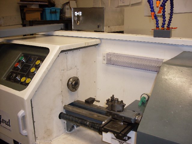

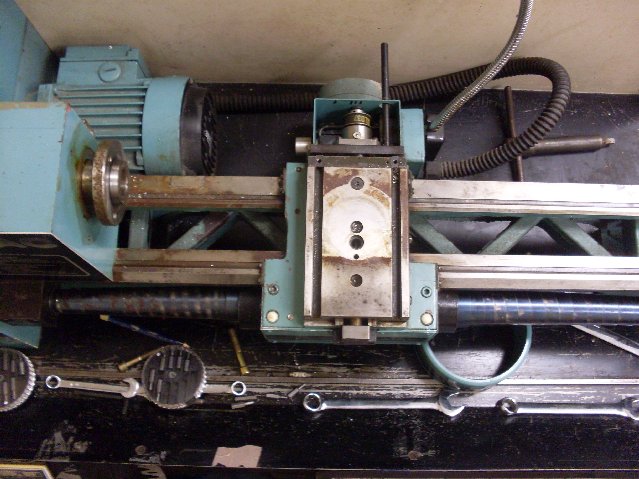

Hi everyone iam new to this site and cnc for that matter. I aquired a denford orac off flea bay it was a in a bit of a sorry state but after nearly 8 months work iam slowly getting it to where i want the orac to be it should be ready for test runs with linuxcnc in the next 2 weeks
now a super orac
work in progress
making a start
she will scrub up ok.jpg (72.04 KiB) Viewed 11462 times

yes and no the tray was built using the original tray and the consul bottom the case and door was produced from molds i made in GRP the skirt that goes round the tray was hand formed using to lengths of angle in the vise to hold the sheet and a rubber mallet to bend to shape same with the controller box onlly part that was cut was a 120 count spindle encoder wheeel which a friend laser cut for me everything else is hand formed.

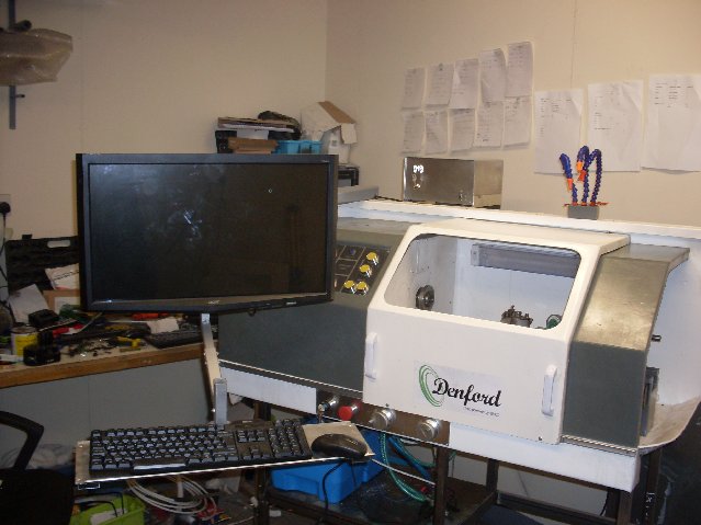

Just a short line to let everyone know the orac is up and running, just a few software configs to add to linuxcnc 90% of it is already done, aquired a denford easimill single phase just waiting on 2 harmonic drives 100:1 ratio for the 4th and 5th axis conversion, will post some pics of the orac might upload a vid the biggest problem was the 2500ppr encoders i added to the Z and X axis but 99% of the problem was linuxcnc being new to me but finding my way round it. just waiting on new chucks and tooling for the orac now going to 125mm chucks so first job is to machine new backing plates, I must say for a training lathe the accuracy of the orac is impressive
once the everything is adjusted using a dial gauge i achieved 0.01 mm variation on the z axis full length of the lathe test bar.
