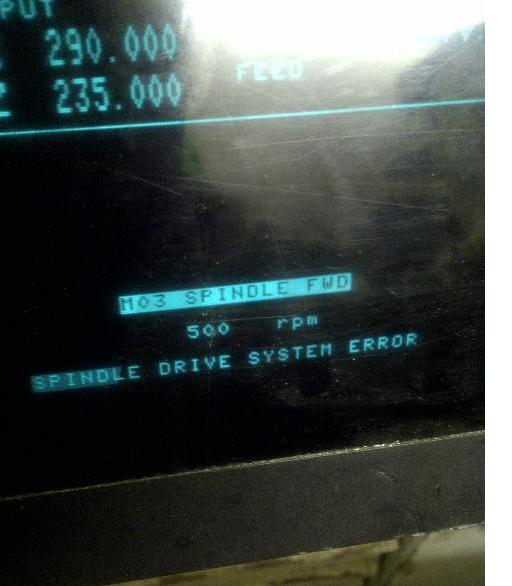

I now still have the spindle fault.
It would try and start, and if I gave it a spin by hand on the pulley, the spindle would start. When I installed the r8 collet chuck, it didnt even try to start and tripped out the house rcd, and agin blew the preliminary fuse.
I am lucky enough to have another complete and working triac, so I swapped the spindle motors over. The fuse then blew again, so I guess there is nothing wrong with the motor?
I now have the original motor back on, with the timing belt disconnected to see if the motor would start with no resistance attached, but it still does not run.
The fuse does not blow, but i get a message saying "SPINDLE DRIVE SYSTEM ERROR".

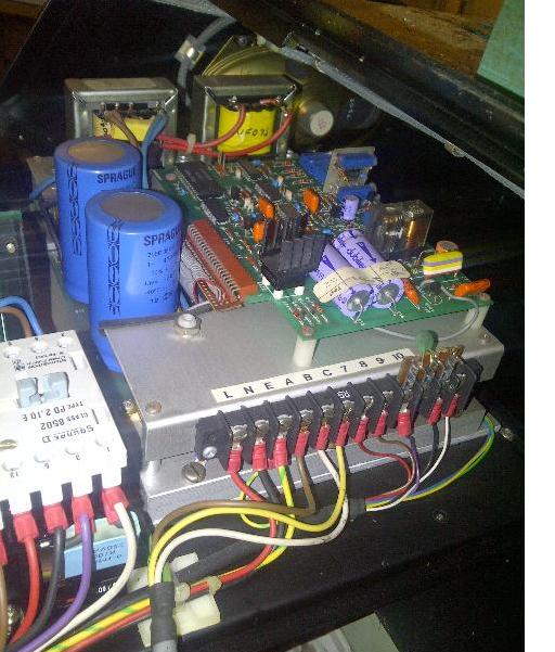

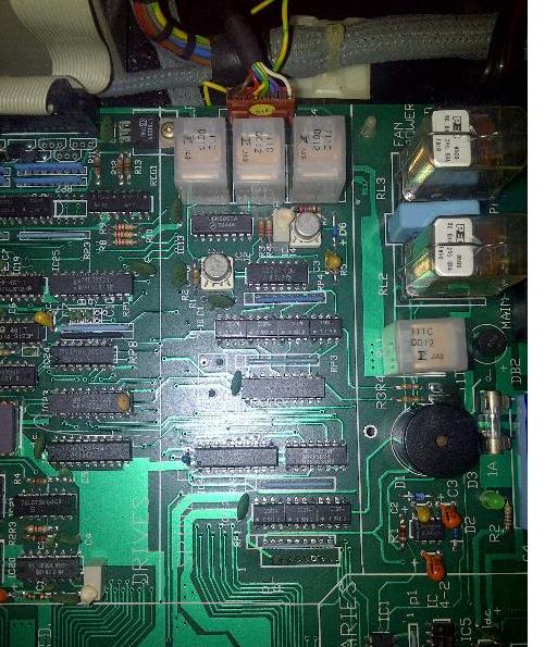

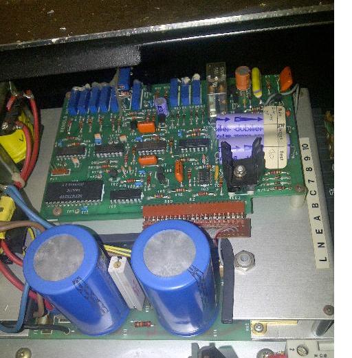

Ok,
I have uploaded pictures of the card which the motor connection go to. I have also taken a picture of the section on the large board at the right hand side of the machine which is labelled spindle.
I have also taken a picture of the screen showing the fault which appears after a few seconds of the spindle not responding.
Many thanks

Re: Triac power problem
Check the power & anoluge to the spindle drive.
When the spindle is requested the control looks for feeback from the spindle sensor & will clear when the requested speed has been reached. If it fails to reach the desired speed then it displays the alarm as quoted.
Thanks Martin,
Excuse my ignorance, but I'm guessing I am just looking for voltage between phases, and an analogue voltage of 0-10 Vdc?
L & N = 240 volts AC
A,B,C are the output to the spindle motor.
7 & 8 are the run command.
The last three will be the spindle anolgue. 0 to 10 volts DC. Not sure which terminals though.

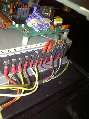

Try shorting out 7 & 8 . Spindle run.
Hi Martin,
I have shorted the two terminals with a small link wire, but it has made no difference. The machine still gives the same fault.
Here is a pic of what I have done
thankyou again for your help
Paul
Paul
- IMG-20111111-00039 (Small).jpg (34.37 KiB) Viewed 16136 times
I would expect there to be 12V on one of the RUN pins - probably spindle run common.
Test both in relation to 0V and 12V
See if you can trace a problem with that - maybe a fuse has gone or there is some other kind of interlock on the board which won't accept the run input until it is safe / ready to run.
if this is the brown and pestell vfd, there should be a set of contacts around the back called the fanning strip which are used for run and 0-10v. and these are 8 and 9 for forward and 7 and 9 for reverse. It looks like 4 and 5 are 0-10v.
Please check first, and be careful as this inverter uses a live 0v rail so do not earth the 0-10v.
