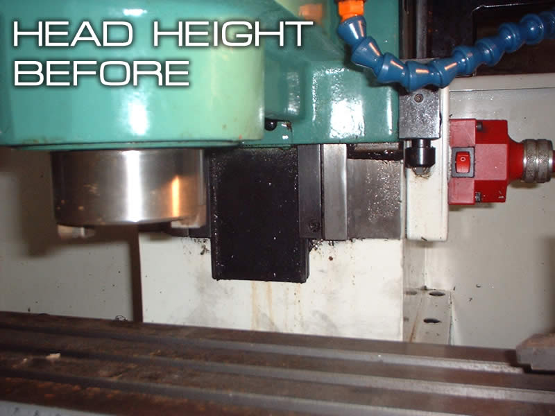

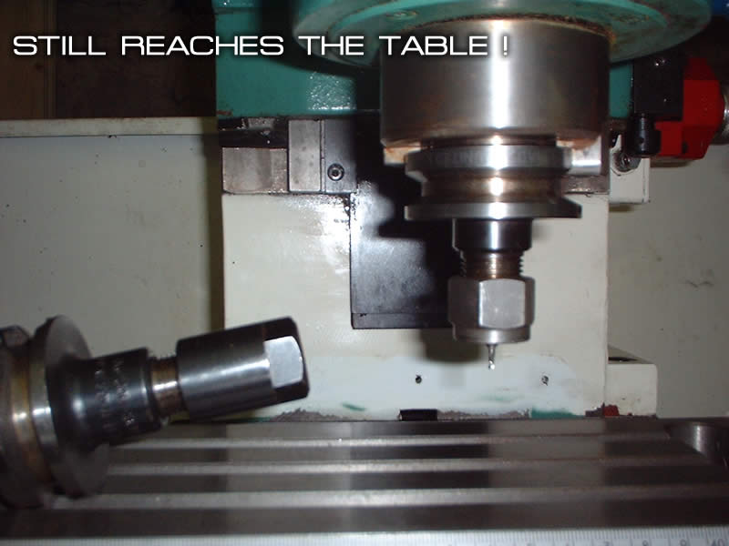

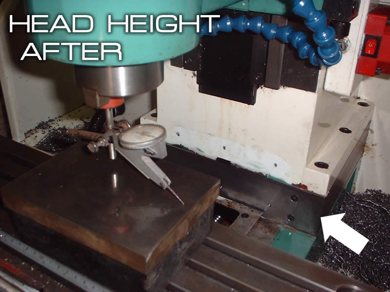

The reason I ask is cos the spindle will kiss the table and still have about 80mm (off the top of my head) of travel.
So... I found some 60mm blocks and raised the column.. tell me how to upload piccys and I'll show you.
The cables are just about long enough and of course the ATC is not affected and best of all you can put longer tools in the changer! or machine bigger lumps
